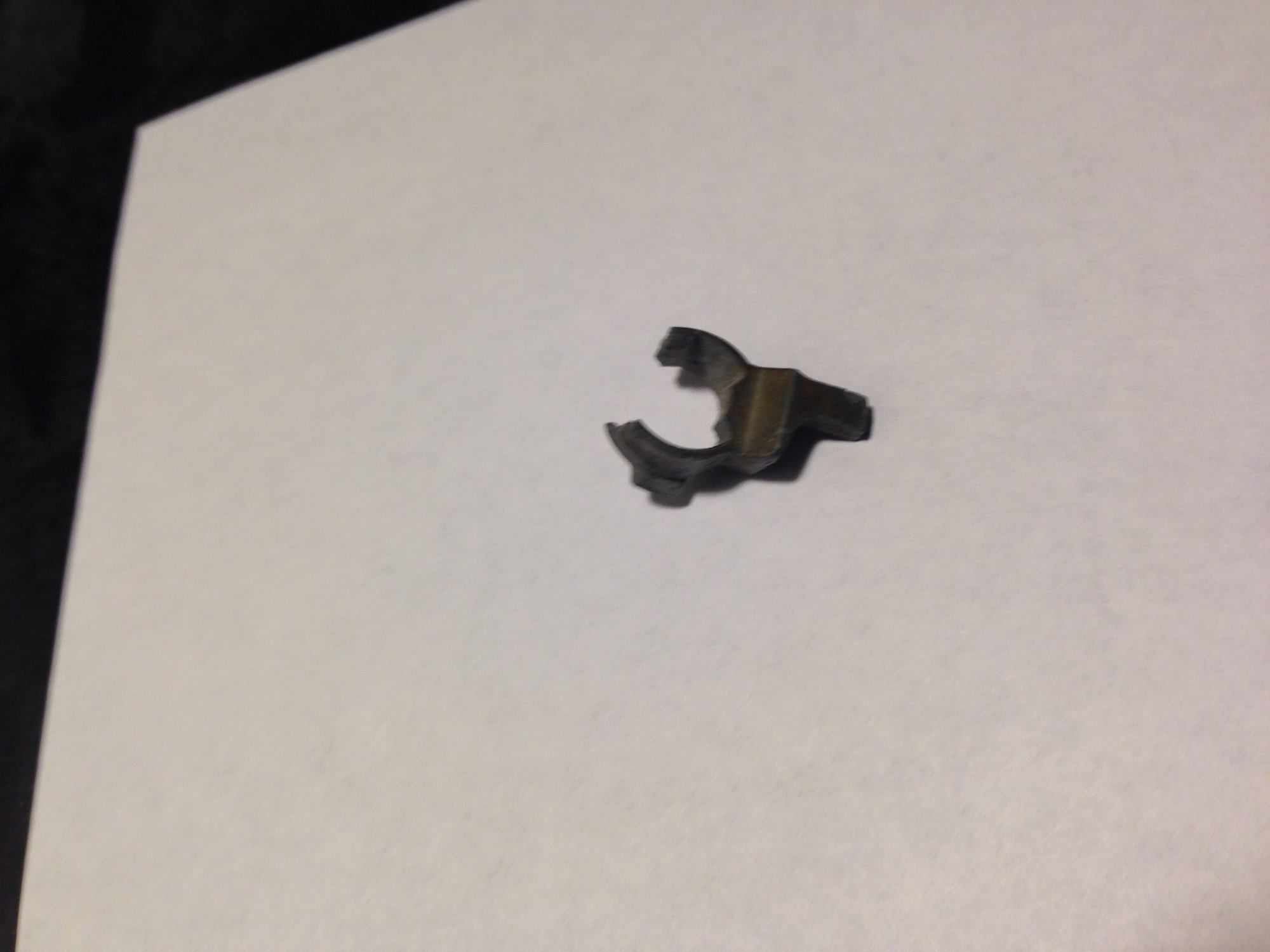

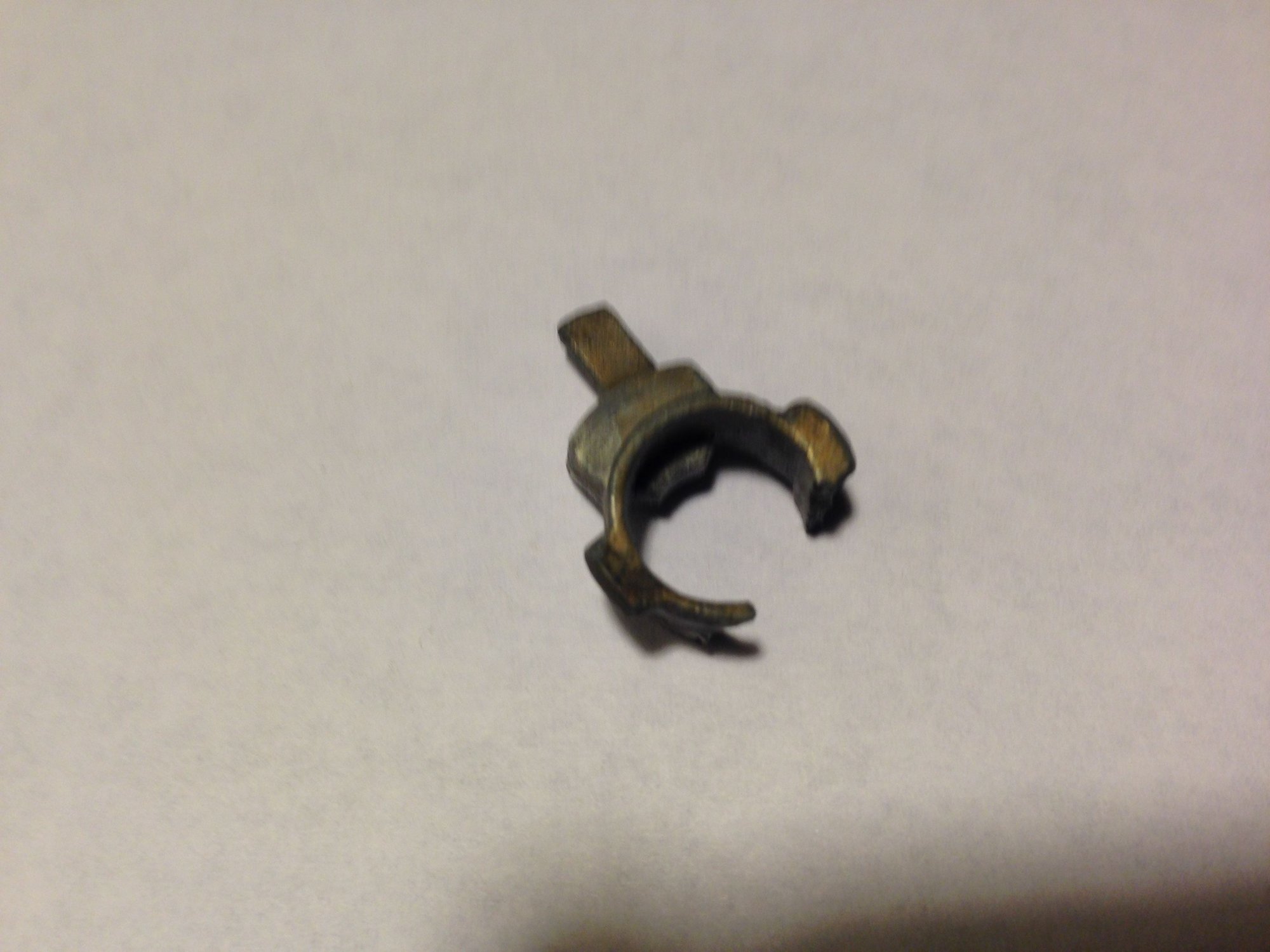

Default here are pictures of part I found inside the door.
I gather this is part of the door lock system:

I may have part of a lock in stock but it will be Monday before I can look. I used to have a used lh door lock asm and that piece you have there would be part of it.
