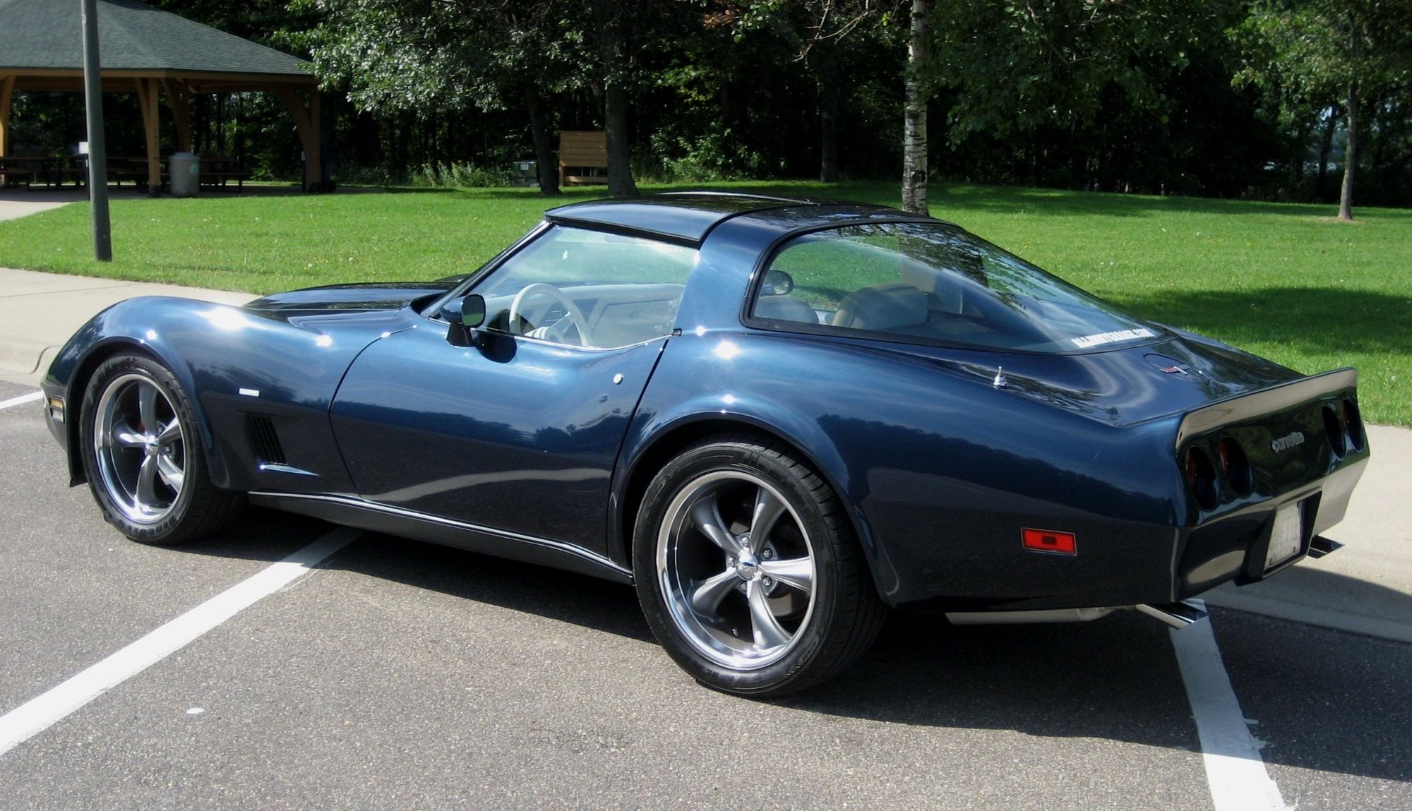

I have 255/45ZR18 Goodyear Eagle F1 Supercar tires at all 4 corners on 18x8 wheels. They are perfect for cruising and an occasional autocross. They are on the soft side (UTQG: 220 AA A), perfect for autocross in the SCCA CAM class (min. UTQG 200). They are an excellent tire for the money IMO ($155 or so per tire plus mounting, etc.).
I got a set of BOSS 338's at a low price I couldn't pass up at the time, but they have a 4.5" backspace compared to the 4.0" of stock wheels. I use hub centric spacers and longer wheel lugs to make up the difference. You could avoid the backspace issue with a set of Coys or some other 8" wheels with a 4.0" backspace.
