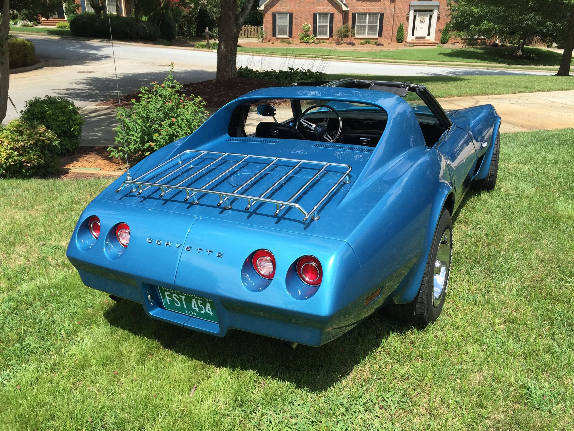

How about the FACT that the split tail '74 is the best looking, especially when looking at your bank account!!
