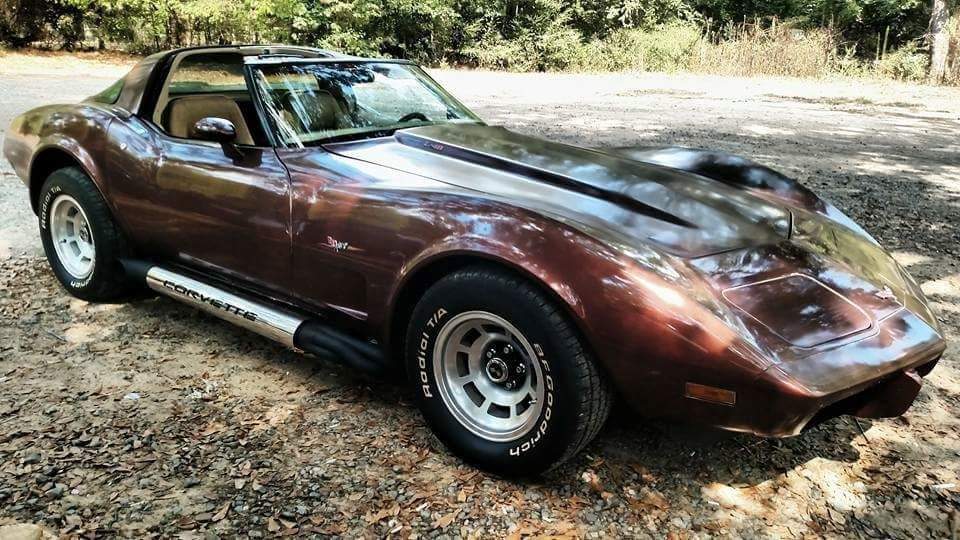

Hello All,
First post newb here, 3ed vert.
Purchased my new baby out of South Texas a few months back and after fixing all the leaks from her sitting up, Im on the quest for some personal touches. Vin shows a L48 but the motor is modded excluding the 3 speed, block and heads (assuming these are the original L48 heads).
She has a decent kick form 3500-6000 RPM but sluggish off the line. Im thinking the mild cam and L48 heads are the culprit. Put a tune on the carb and timing, balancer replaced, new plugs, less restrictive breather and still like a turtle off the line.
Now coming for a '73 big block hitting 11 to 1 on the comp ratio, you can imagine my
Any input on getting a better line shot????
