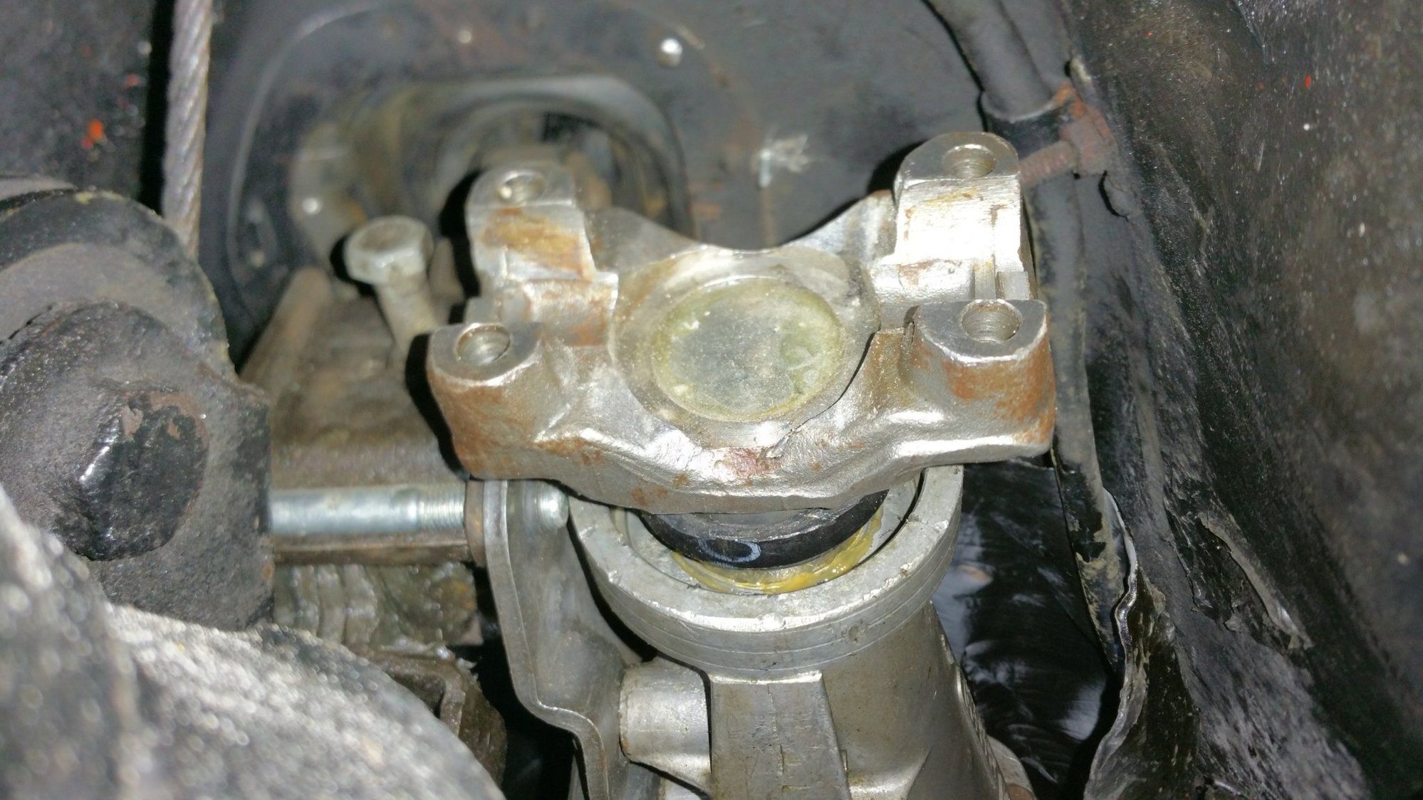

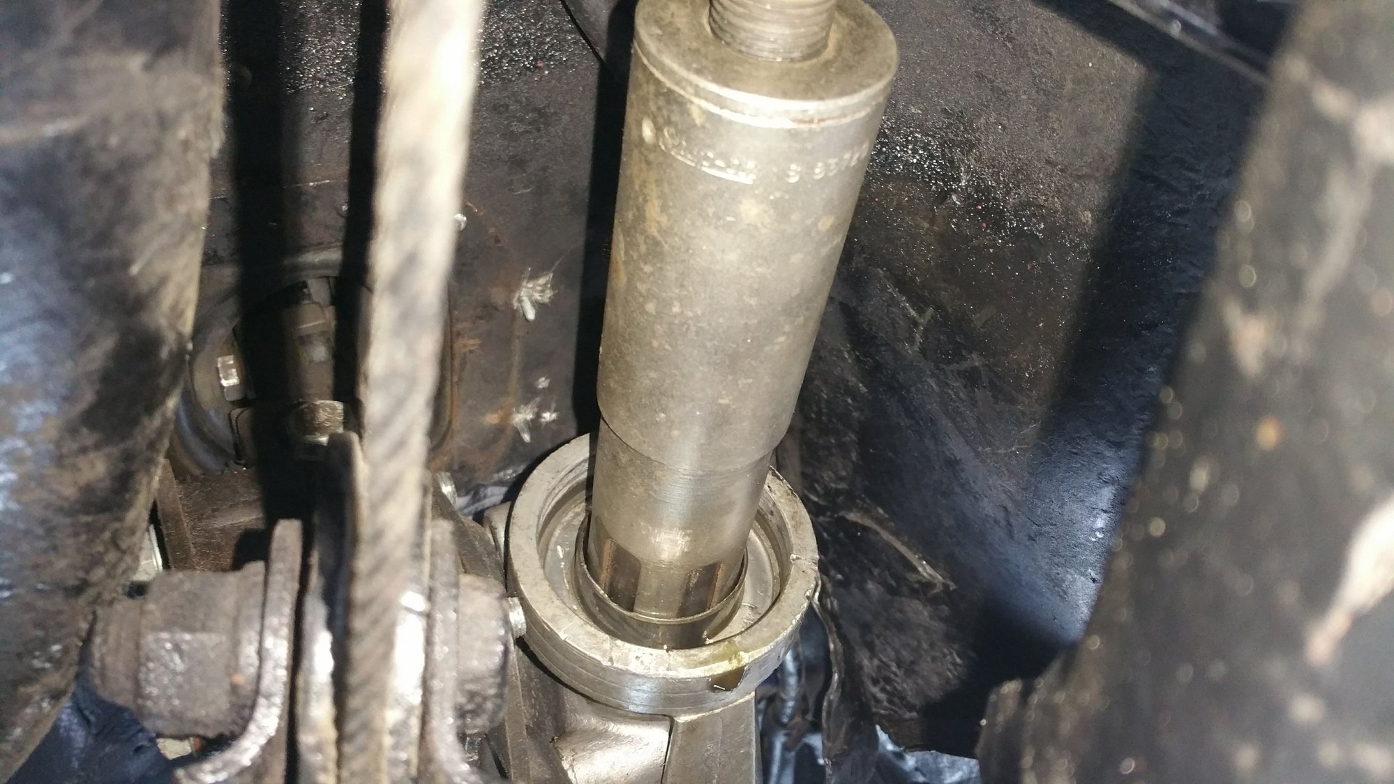

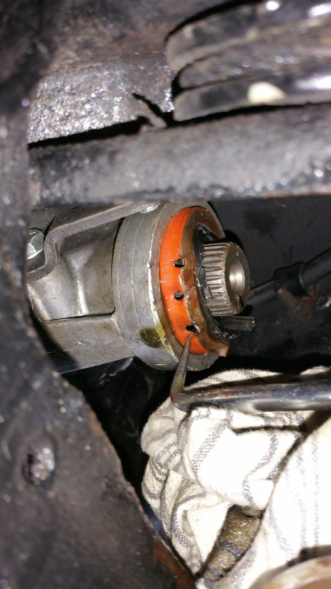

I had .125" end play with the drive shaft I stalled on my m20. I drove mine onto planks supported by cement blocks. Made sure it was super stable as I didnt want to be jerking on the seal on jack stands. I got the puller from ebay. Used a pick to punch holes in the seal as there was no lip to pry it out with a screwdriver. The puller pulled it out nice and smooth.

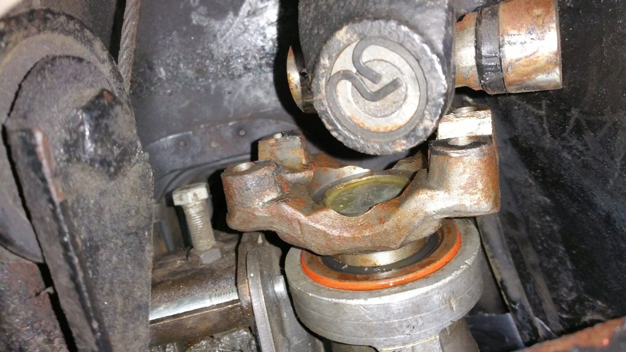

I put the old bushing on the slip yoke with the new one on the end to press in the new bushing into place. It was the easiest way to keep it aligned. Worked great.
No lip
Punched pick into old seal
Snap on tool makes it easy
Well greased yoke slides new bushing in to keep it aligned
Old bushing with 1 1/2 pvc pipe to keep it tight to seat the new bushing as its is far in the housing
Seated
