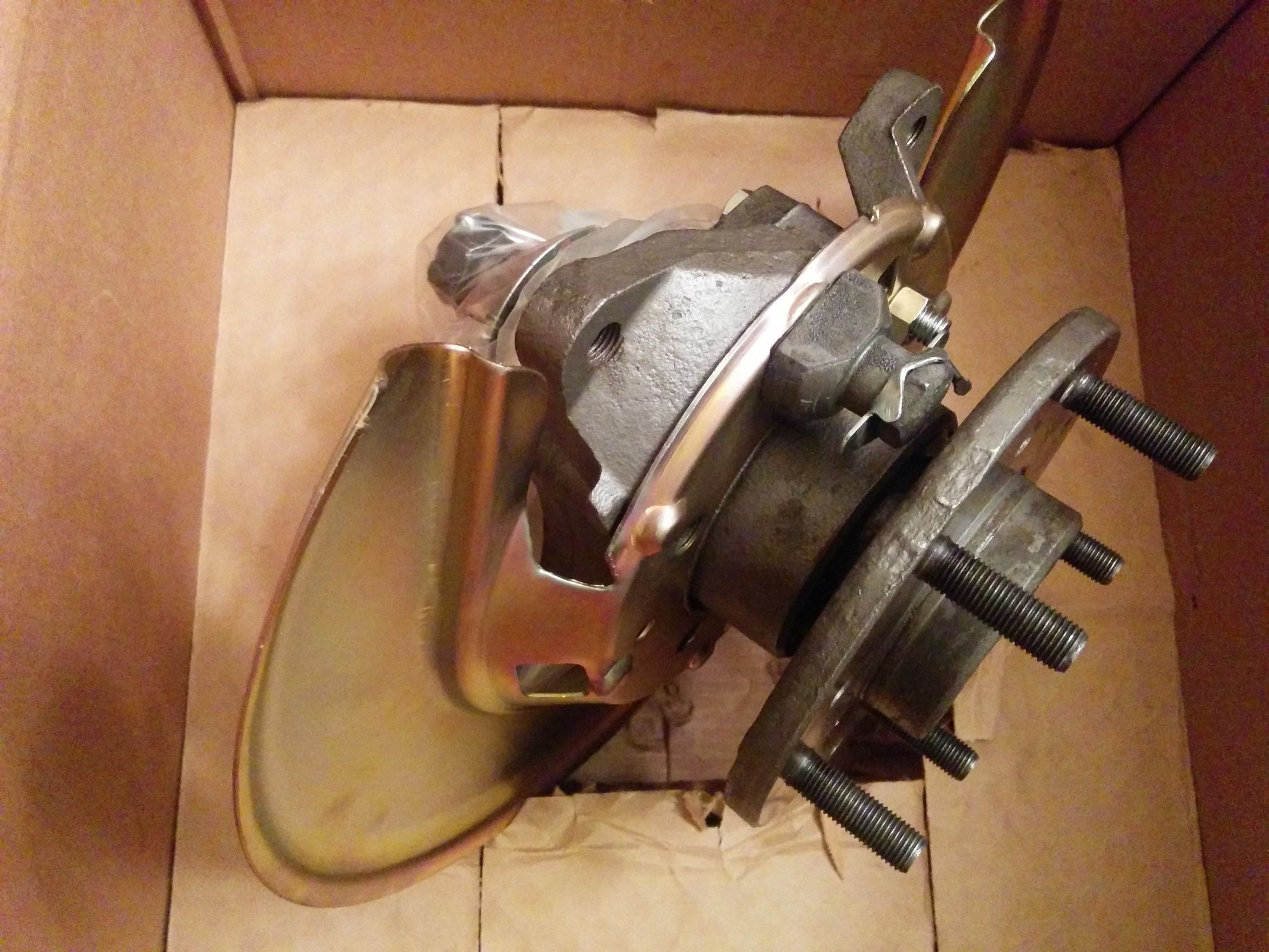

I wouldn't send in the whole trailing arm for the bearing job; just the bearing carrier assembly, which can be done with only mechanic's tools.
Here's the part I received from V-Tech Corvette in Rockford, IL just yesterday. I'll be installing it this weekend.
