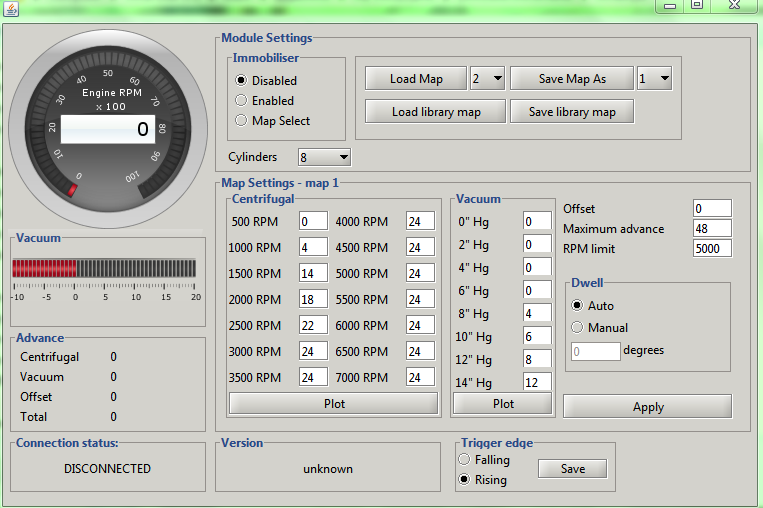

Possibly wont interest many here as it is a "Pommie" device but I used this unit, see pic because I wanted to retain the stock distributor and is not too conspicuous (but I have removed the vac can as not needed). Unit seems to work okay, is compact (about the size of a cigarette pack) and will run with either points or electronic actuation. Dist is locked on full advance and the timing set with whatever static figure you require. The Amethyst unit then controls both the ignition advance electronically and the vac advance by inbuilt MAP sensor. So, in my case I have 10 deg static plus 24 deg "centrifugal" = max advance 34 deg.
You also get an inbuilt immobilizer feature as well as a rev limiter one.
Amethyst ignition unit
Advance curve SBC
Vac advance curve
Amethyst software

34 total, you using vortex heads? If not you prob should try 36-38, assuming your timing pointer is correct, otherwise give it what it likes.
I've seen that UK ignition box before when looking up something. Looks nice and compact, but..........

Amethyst ignition unit looks like a very nice and has more functionality than the Mallory unit being discussed. Oh, it has USB 2.0. That's a win right there!!!

Hi, no Vortex heads fitted, seems happy enough at 34 deg on our fuel, I had it at 36 before but didn't seem to make it go any better, I was advised to back it off a bit to be on the safe side.
