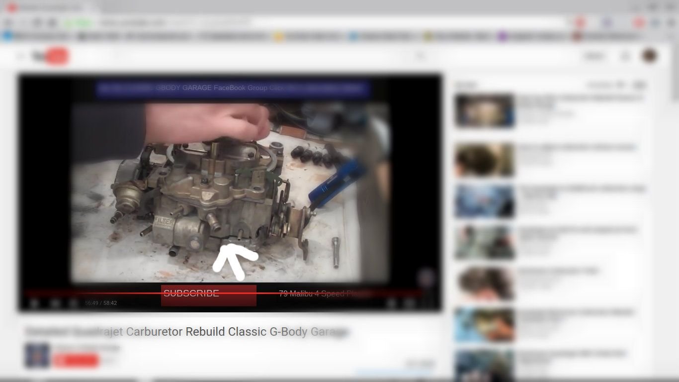

Hello all, filled the 1980 up yesterday and now it seems real sluggish and boggy.Idel seems low but still sits on 700 like it used to.I got to looking at the carb and noticed this larger fitting has nothing attached to it. Is this right ? Any help or other possible causes will be greatly appreciated.

Believe it goes to pcv valve, just filled, but sounds like lousy gas or water is possibility.

I think it leads to the charcoal vapour canister and the pipe at the bottom centre is for the PVC.
Thought they were visa/ versa very possible i'm mistaken. It's one or the other
