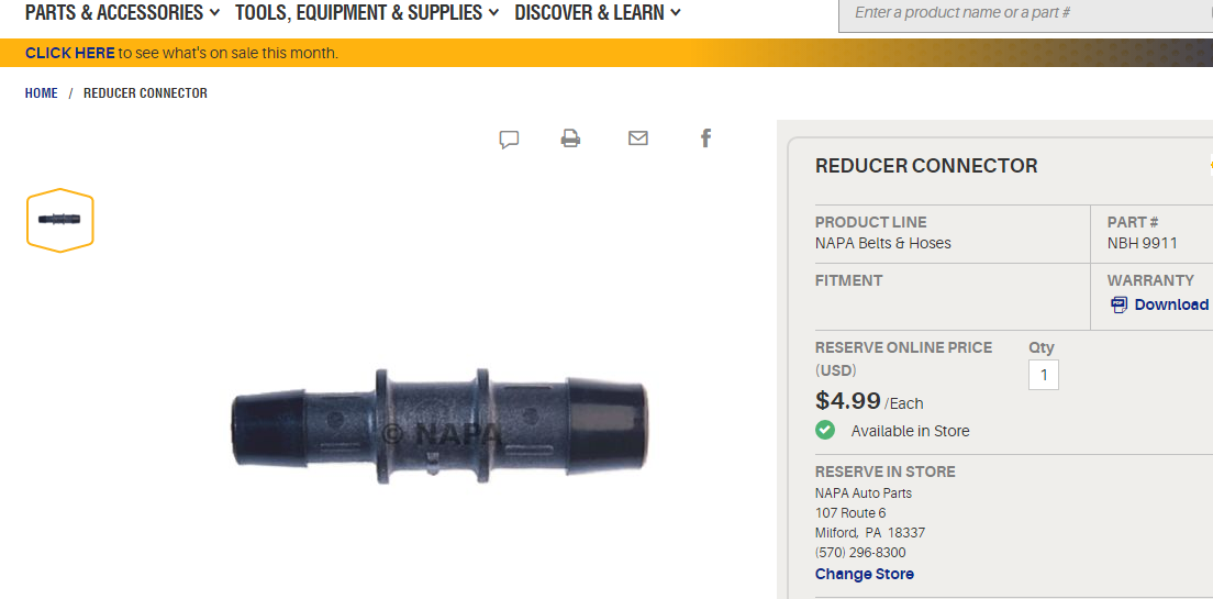

Step One: Get the following part from NAPA; this is 5/8 on one side and 3/4 on the other and will allow you to loop the lines together to bypass the heater core. Also have handy 2 hose clamps.

I bought this.
The hose ends are 5/8" and 3/4" which is an exact fit.
http://www.ebay.com/itm/CAMARO-FIREBIRD-CORVETTE-GTO-HEATER-HOSE-BYPASS-LSx-ENGINES-LS1-LS2-LS3-LS6-LS7-/161319320425?hash=item258f617b69
Then I used brass barbs to connect it.

Long term, I will plug it, but on a Sunday there wasn't many options (parts wise) and I wanted to
So for $4.99 and about 10 minutes of time it did the trick
