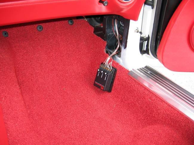

One other thing to consider with components, is where to mount the crossovers; they are not that big, so it's not really a problem, just something to consider. I mounted mine inside the #2 body mount cavity. Here is a pic with the passenger side crossover pulled out:

First off, thanks so much for the detailed reply with photos it sure helps.

If you are mounting them in the kickpanels, will you be mounting them behind the panels.One other thing to consider with components, is where to mount the crossovers Behind the kickpanels, what size would be the largest and yes I can trim inside the kickpanel area. I forgot about the crossover, thanks. Thanks again Bruce.

Originally Posted by resdoggie
I found a pic of mine mounted in the kick panel. The kick panel goes over it without bulging. A nice clean install if that's what you're looking for.
Thanks, I just need some recommendations on model numbers.
