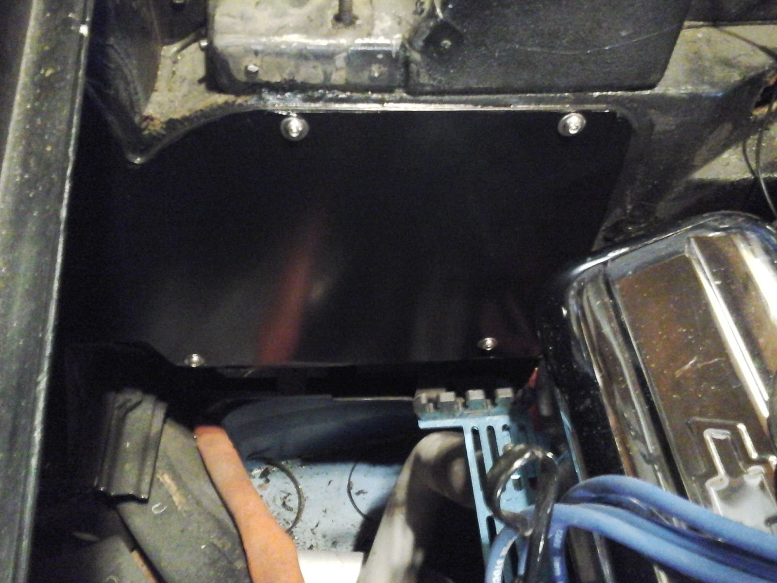

Ordered A/C delete cover. going to start taking stuff out when weather breaks, we seem to be back to winter this morning snow everywhere dam.

Installation is easy but take you're time.
I transferred the fan motor's metal reinforcing ring and used some silicone to bond it into the housing just to cut any sound vibration. Play with the position of the motor and ring until you are happy then mount. I also transferred the fan air cooling intake pipe to the cover. Drill undersize holes and then use a cone to open to size if you are not sure of the fit, keep a shop vacuum running to suck up the dust.
I made a cardboard copy of the cover - as received. Use a good thick cardboard. I had to add a small patch / extension on one corner with some fiberglass cloth and resin. Trace the holes for the screws to the cardboard. You can enlarge the cardboard holes and then use tape to zero in on the hole location on the cardboard. BE SURE TO MARK THE CARDBOARD INSIDE AND OUTSIDE. (facing rear / front ) . Trace the holes and test fit the cover, Sand if necessary / fill if necessary to get a fit you are happy with. I used strip gum / gunk - some people use black silicone on the lip. I used fender washers in SS on the cover with the screws - painted black. Mount the cover and snug it down - not tight. Then the next morning you can tighten it down to where you are happy with it. I then put the strip gunk around the perimeter to look stock.
Most auto stores have the strip gunk in rolls for a few bucks. Use rubber gloves - the warmer it gets the sticker it gets.

copy of the glass work, you can use a water neck gasket as a templet for most resistor holes - copy one and adjust as necessary.
I had to adjust the bolt corner to fit the way I wanted it, a little cloth and some cat hair - Bondo with fiberglass .. sand and paint

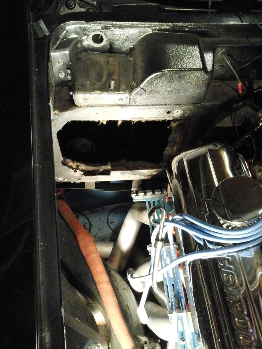

Took all the a/c stuff out today. Almost had a temper tantrum. Got it all off, but what a bitch, and I do not mean maybe!!! Ended up cutting 2 pipes, fittings were jammed solid bummed about that. Also had to split box to get it out. I don't know how many bolts and screws but there always seemed to be one more you can't see. Screwed around about 8 hours on it, but it's ALL GONE. Pretty frustrating job overall. Don't know if I'd do it again.
Old Mar 26, 2016 | 08:31 PM
cocoa312000's Avatar
cocoa312000
Joined: Nov 2014
Posts: 23
Cuts out a lot of clutter. Now for some chrome.

I did mime with the engine out. how much debris was in the box, mine was 1/2 full of junk - leaves and Pine needles.
Old Mar 28, 2016 | 07:59 PM
cocoa312000
Joined: Nov 2014
Posts: 23
This one to was half full of junk . Still waiting on cover. Working on header install while I wait for cover.
I had to do the same thing. I only had to cut one pipe though. It was the aluminum one that was near the radiator. I tried everything to loosen that fitting with no luck so I had to cut it.
It took me just about all day but after cleaning everything up and installing the AC delete cover it was SO worth it. Engine compartment is so much cleaner now.
