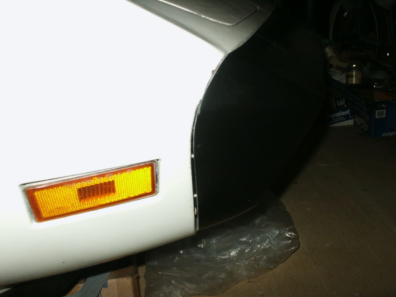

I don't have a photo of mine before I installed it, but I
have these of after the fitting and installed. Note, I had
only one area that needed work and it wasn't hard to fit
that.
Area needing fitting:
After fitting:
Complete:
Donnie
