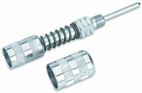

If you have Slotted Thread Flush Type Grease Fittings (SAE Products 1/8" NPTF) like this,
You can pick up one of these (Amazon has them), and grease them through the flush type grease fitting...
* For use with most hand-operated grease guns
* Excellent for use on 4 wheel drive universal CV joints
* Quick connect to standard and heavy duty grease couplers
Amazon.com: Lumax LX-1414 Silver 1-1/2 Amazon.com: Lumax LX-1414 Silver 1-1/2" Narrow Needle Nose Grease Dispenser: Automotive
Or you can pick up some 10-32 thread zerk fittings (Moog item number is 620) and change them out to grease the joints as you would with any other grease fitting. I would try where you picked up the joints first, or a local NAPA store. Apparently they are smaller than the typical zerk fitting and not nearly as common.
Good luck... GUSTO
I do apologize, the fitting listed above, Moog item number is 620, is a flush mounting fitting, the standard zerk you need uses the 10-32 threads,
and is available here, http://www.saeproducts.com/grease-fittings-H1032.html, from SAE Products if you can not find them locally.
