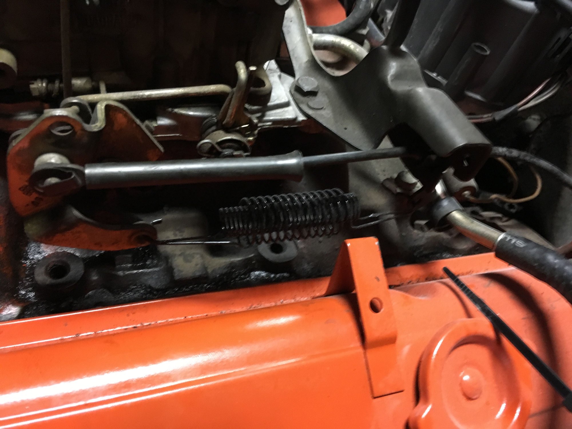

If the shaft bushings are leaking how obvious would the leak be? I've got a wet spot driver side below the shaft and I do smell gas a lot when using full throttle. I've tried to identity the leak holding rpm up. No real evidence of it actually coming out the carb

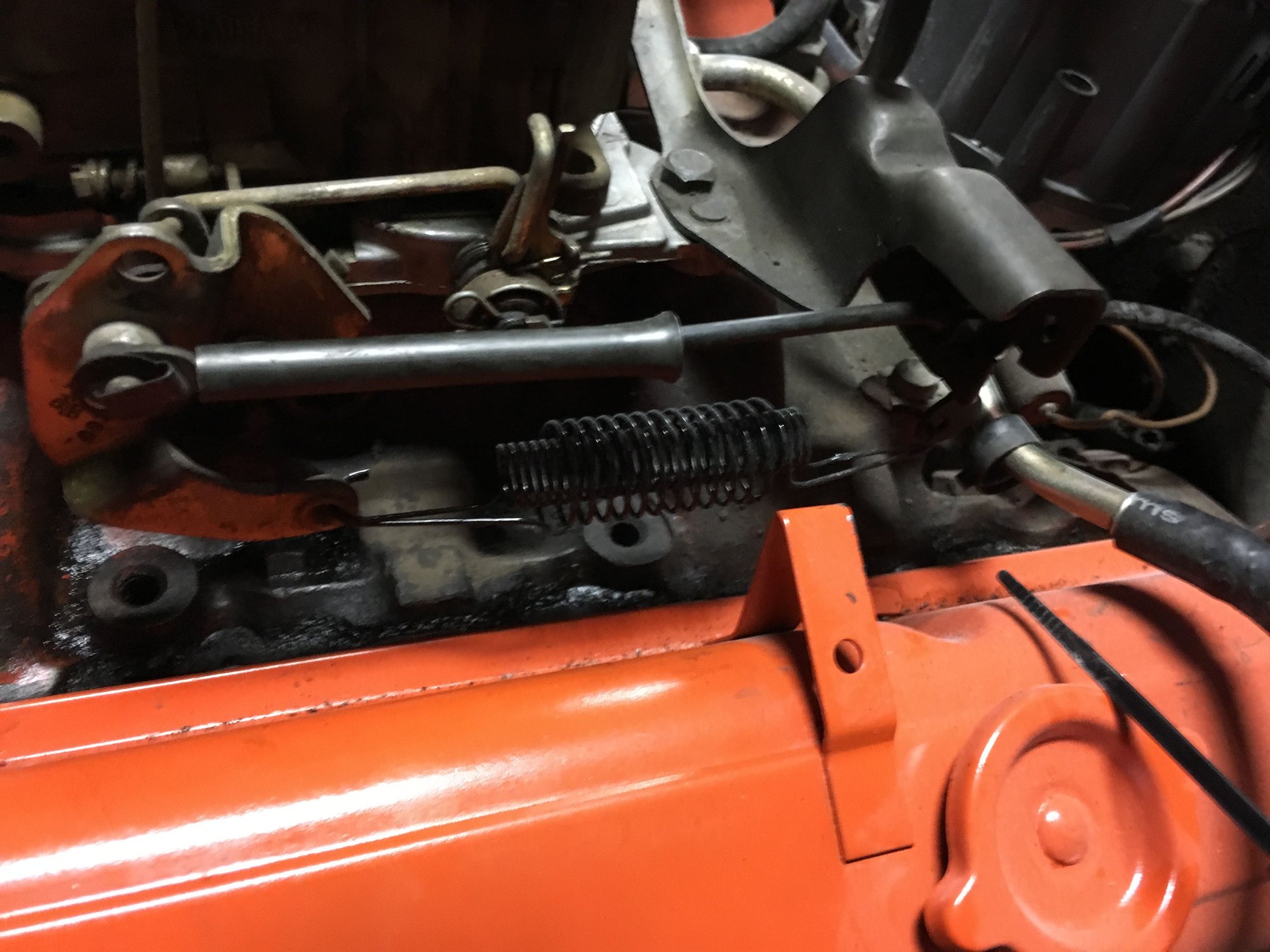

Old Mar 31, 2016 | 07:29 PM
croaker's Avatar
croaker
Posts: 2,364
Likes: 103
From: Centerville Louisiana
Old Mar 31, 2016 | 07:34 PM
croaker's Avatar
croaker
Posts: 2,364
Likes: 103
Old Mar 31, 2016 | 07:35 PM
croaker's Avatar
croaker
Posts: 2,364
Likes: 103
Sorry bout the double post. This is where the accumulation is

If the carb is leaking gas, chances are it's coming from either the gasket between the airhorn and fuel bowl or, more likely, from the fuel line at the inlet. Gas would easily run to the area in your picture in either situation, because that's just a low point where fluids can accumulate (though I would expect it to accumulate more so on the passenger side).
Check the tightness of your fuel line at the inlet before doing anything, unless you already have. I'd avoid driving the thing until you sort it out.
