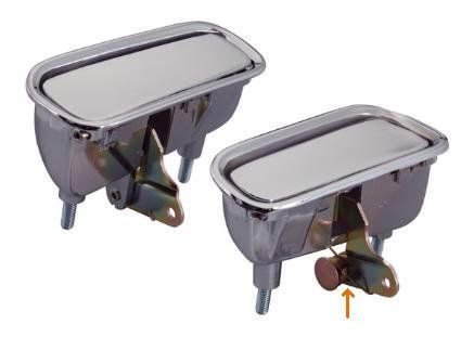

Try pushing down on this part:

There are two springs, one that pushes the chrome flap back up, and one that goes around the shaft of the lever that goes down to open the door. The flap can pop back up, but the door still not open when you push down. When that spring goes, you can't lock or unlock the door and it won't open with either handle. Here's the one that does the work:

This works. Roll the window down and use a long screw driver or other stiff rod through the rear part of the window opening. Use a light in one hand to locate the bar in the pic and push down. Once you figure out where the bar is from the top and have done it once it's about a ten second job.
