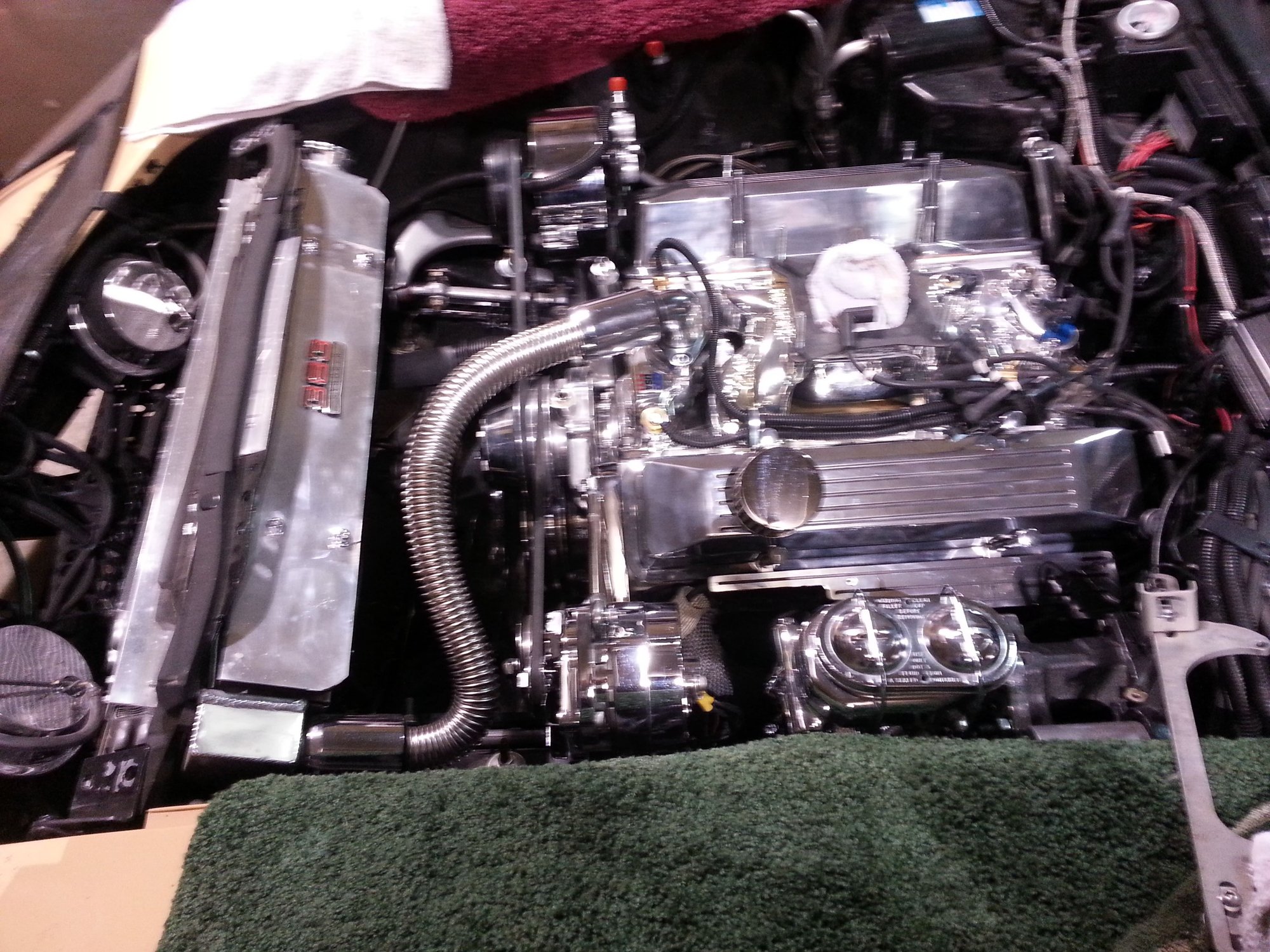

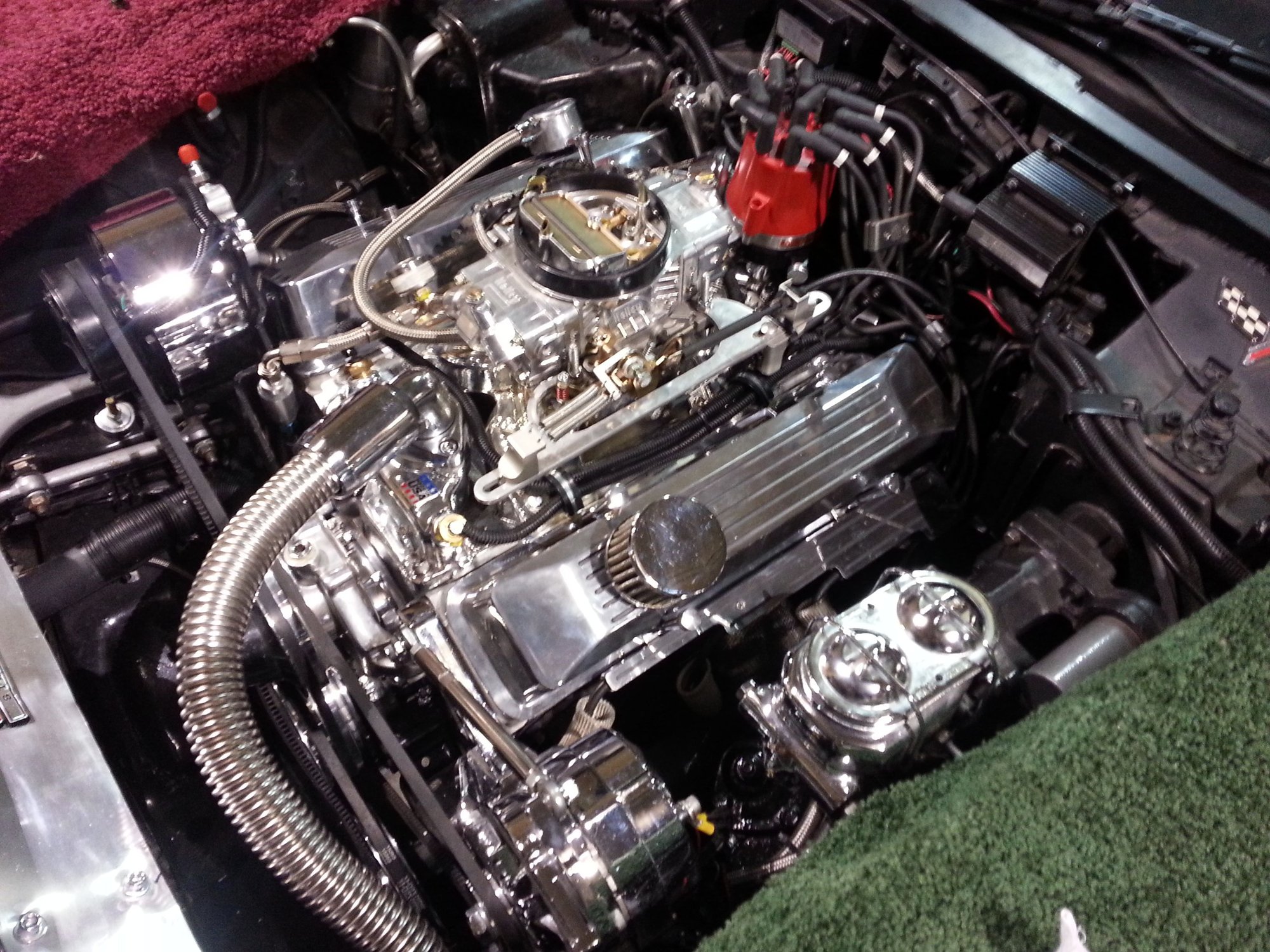

Pretty engine. Wish it ran as good as it shines. <br ><br > hydro boost brakes, 4 row radiator with dual spal fans and electronic fan controller.
