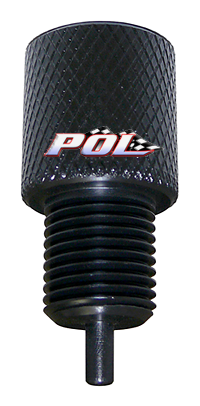

I went crazy trying to get the brake light off after a brake job. I purchased this tool and bled all of the calipers. The tool centers the piston while bleeding to equalize the pressure through the valve.Just take the switch out of the valve and replace it with the tool. then bleed the system. It worked like a champ and costs about $10.
