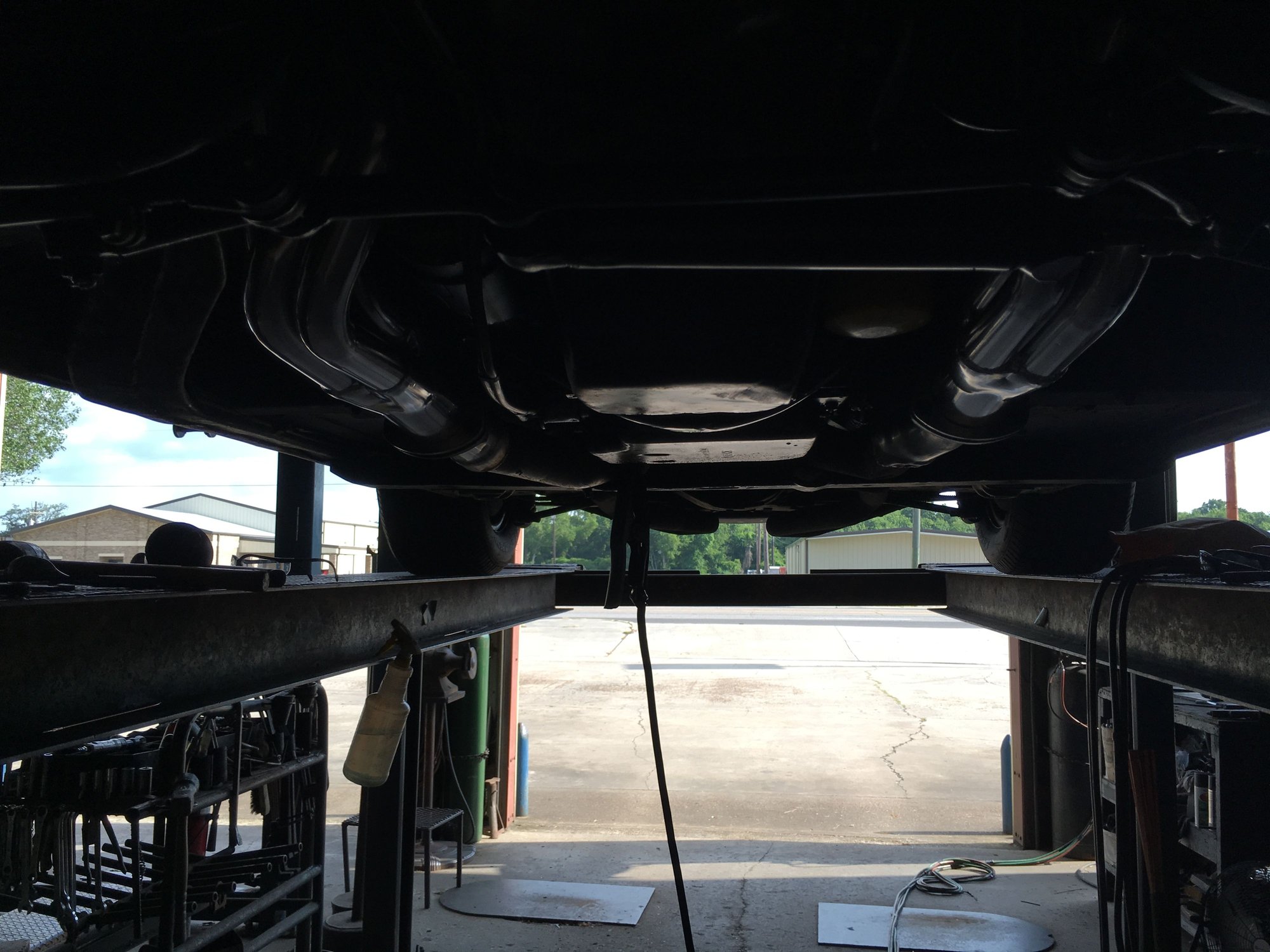

I did the Flowtechs too. I chose them because I can use them with angle plugs when I swap engines. They tuck up tight and easy fit. Only thing I can say negative is they seem a little close to Idler arm bolts.
