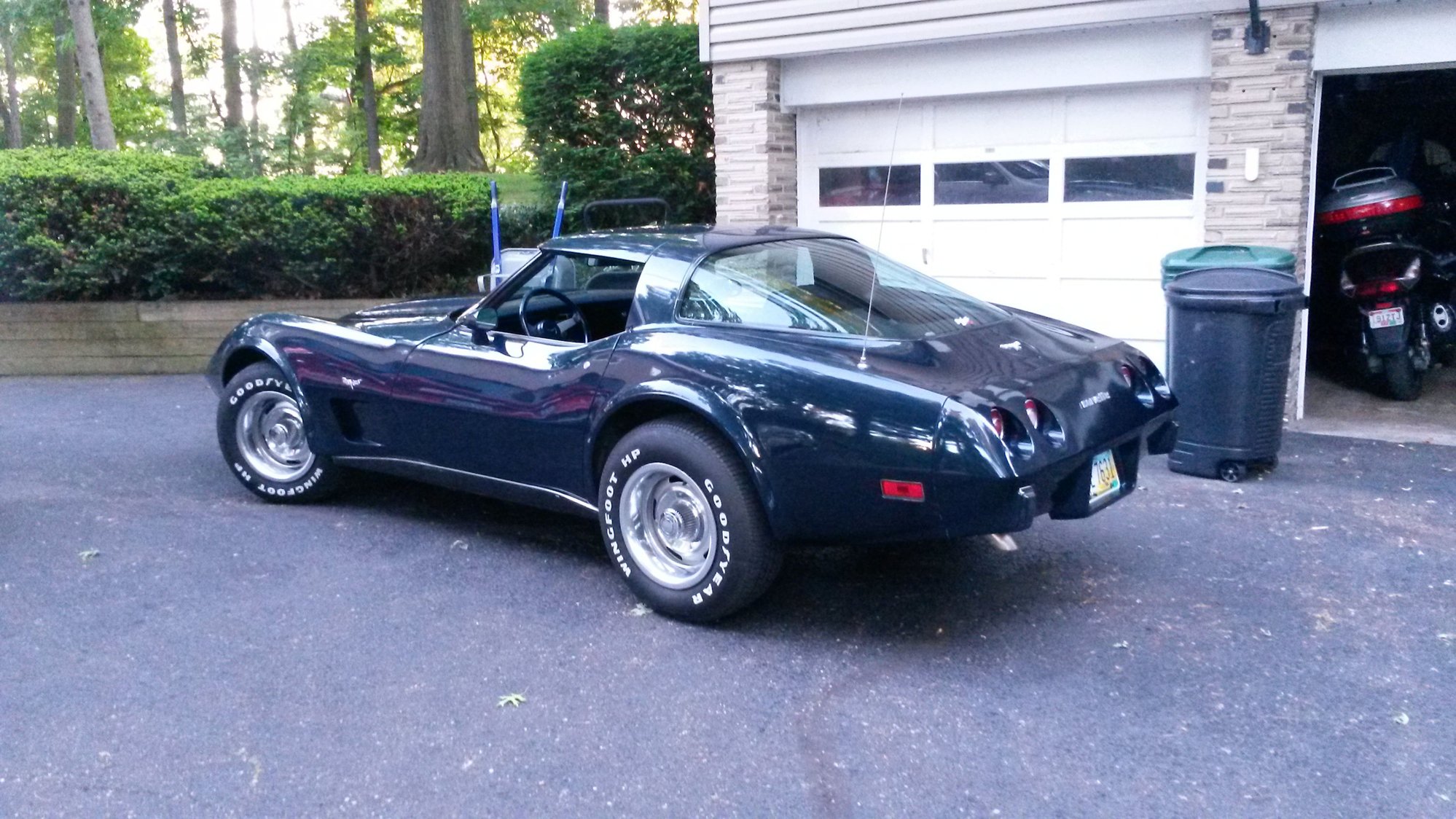

PS, What is the up grade size orifice tube? Token pic cuz we like pics!<br ><br >
