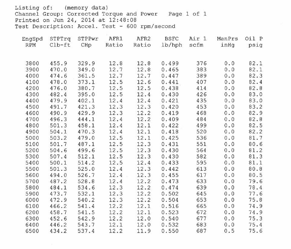

Those heads and 550/530 237/241 on a 108 LSA cam will make over 500HP and 500#/ft. Will have over 10" vacuum and run any power options.
The dyno sheet is a 383 with AFR195's

except, he doesn t have a 383 or that cam ........................................ ........................................ ......................................Ca mshaft Part # 12-433-8 Grind # XR288HR-10

The OP has said he is building a 383 strocker . If you look on AFR website they have two builds showing using the 288 cam . One shows 503 hp and the other shoes 530 hp . Booth of these builds also over 517 ft lbs torque . I think it can be done
Is there a big difference between the 108 and 110 lsa with everything else being equal?
