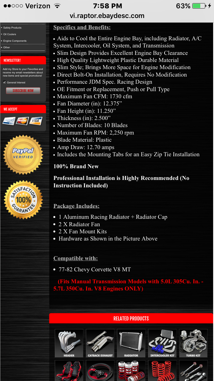

https://www.ebay.com/ulk/itm/191130471141 hey guys I'm thinking about buying this radiator for my 82' but they say it is only for standards and can be made for a auto. What do y'all suggest I do to make it work for my 82?

Well, I'm confused.
The chart says that it is a direct fit for an 82. ALL 82s are automatic, so I'm not sure what mods are necessary??
Old Apr 20, 2016 | 09:01 PM
antoniov1's Avatar
antoniov1
Joined: Aug 2015
Posts: 360
From: Abilene Texas
Click the item discription and look at the very bottom of their website.

Originally Posted by antoniov1
...What do y'all suggest I do to make it work for my 82?...
Don't attempt to make it work. There is nothing generic about Corvette cooling systems, so any time you see an aftermarket vendor making such claims about their product, they don't know what they're about.
Skip this and keep the money in your pocket.

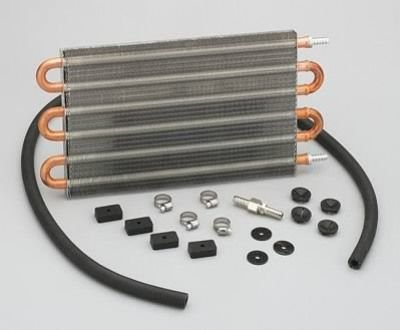

Originally Posted by billschroeder5842
Well, I'm confused.
It doesn't have a transmission cooler. You'll need to use one like this.
I wouldn't do it simply because it said ZIP TIE installation.
