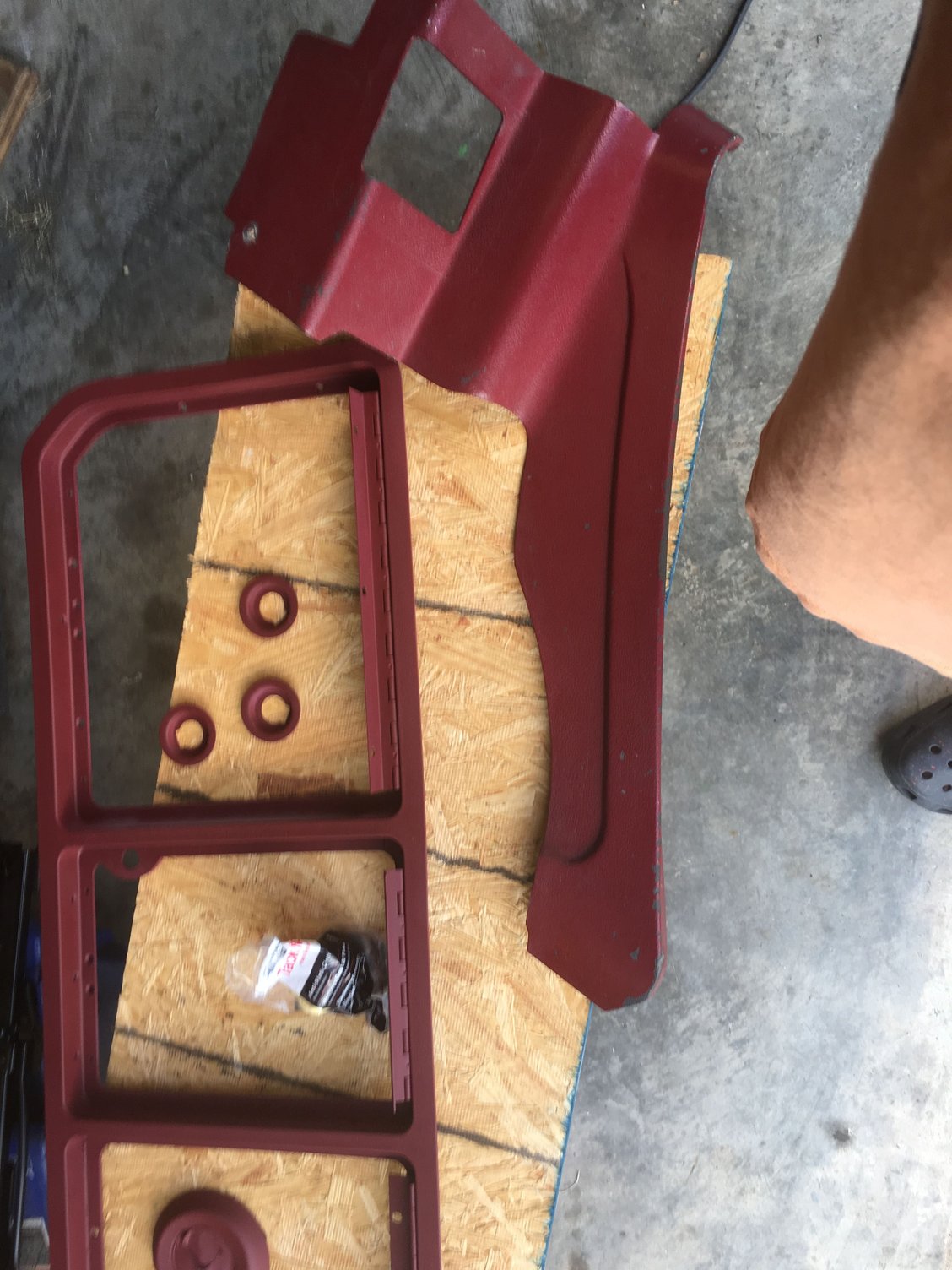

Dying some stuff I have about 4 light coats but they look flat? Oxblood is the color the quarter piece is not painted just for comparsion<br ><br >

I just recently dyed the same side panels on my 73 convertible. It is oxblood too! I got my dye from Corvette America. It was dull when it dried also. If you apply a few coats it does get a little better but not much. So I also use a matte/"satin" clear coat by Krylon. It gives the part the right finish. I usually spray on 2-3 coats. I've attached some photos below. The first is my horn button with 3 coats of dye and 3 coats clear. I used semi gloss clear on the horn button. You can see the differences. Hope this helps.
