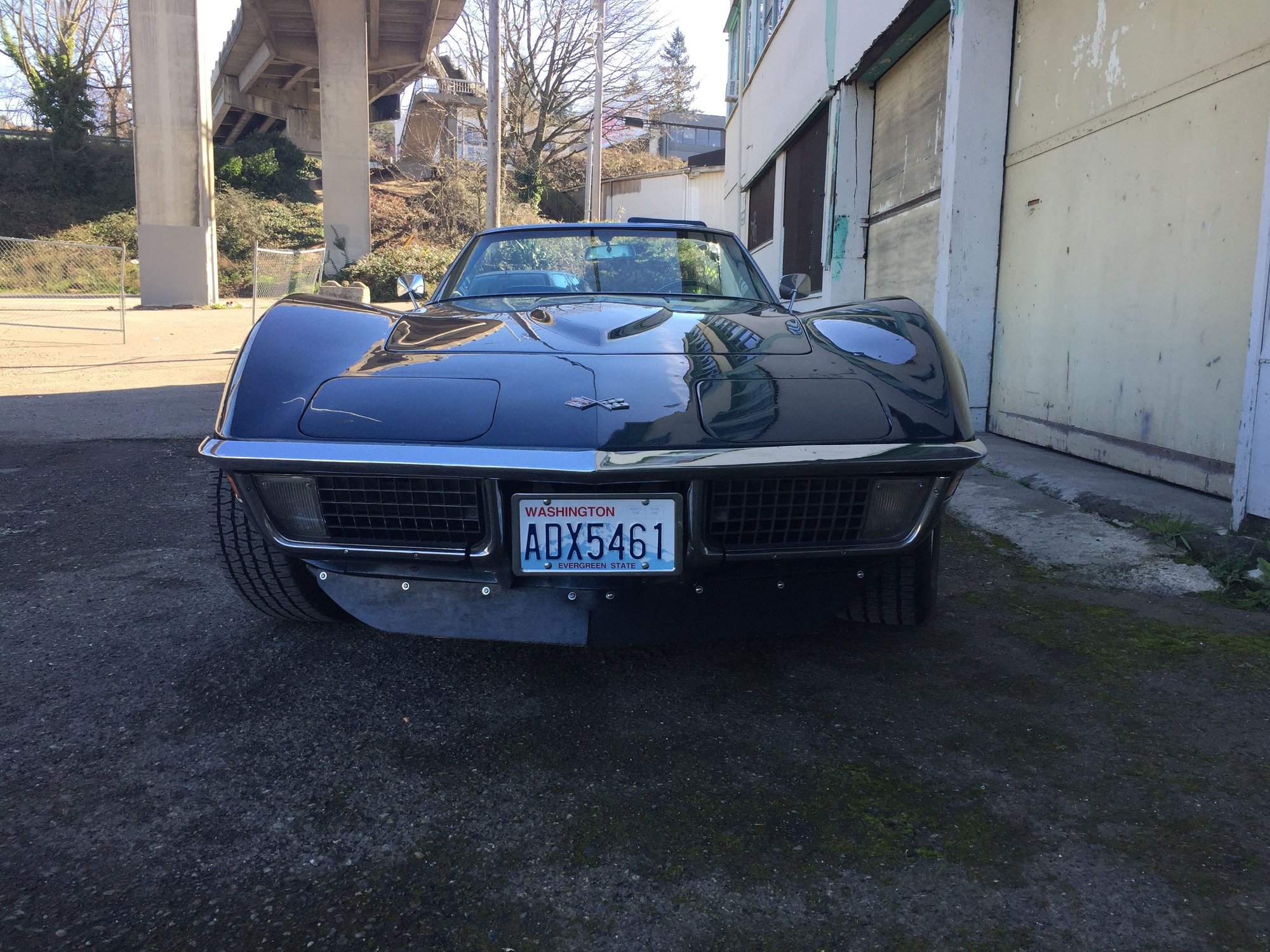

Yes. The car breathes from the bottom and needs that dam to direct air up to your radiator. I put this on top of the original air dam on my '71 to improve cooling.

The Lower Radiator Extension that Robert (rcread) has on his car was sold over the counter back in the late 70's for about $20 if I remember correctly. It attaches to the stock Front Air Dam with two strips of (about 1" wide) metal that "sandwich" the lower portion of the front air dam. The front air dam appears unseen, but it is there behind the extension.
