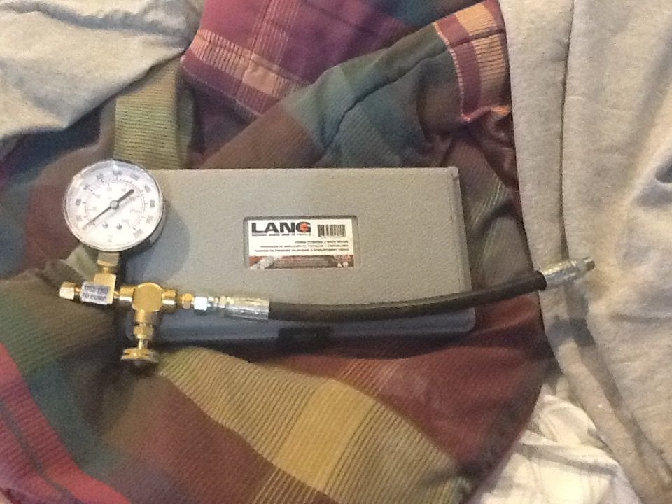

Put a gauge on control valve to check pressure

You can test for pressure from pump to valve,if good then probably valve, believe you can test ram seperate to isolate parts of system
Old May 8, 2016 | 05:39 PM
Calo69's Avatar
Calo69
Joined: Sep 2014
Posts: 1,430
Likes: 59
From: Long beach NY
St. Jude Donor '15-'16, '18
I use this
