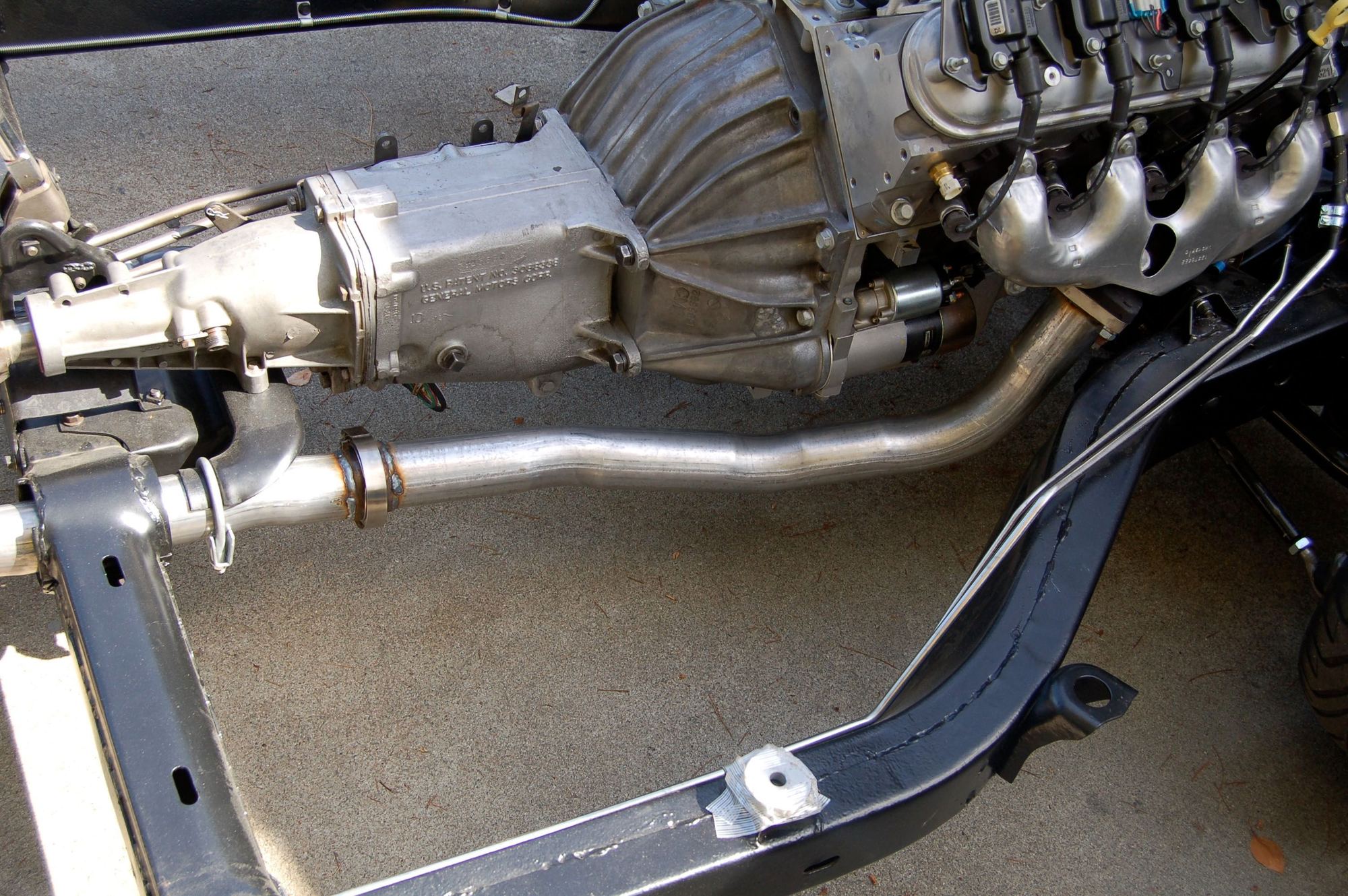

If you're talking about the butt-joint flared-end connectors as below, yes they are great. Easy separation. I don't know the correct terminology but recommend them unequivocally. They are welded in so unless you can do this yourself, you'll have to visit a muffler shop, probably with the connectors in hand. And to get a proper seal, they need to be welded with the pipes installed in place.
