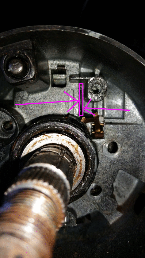

OML wished I had read this like yesterday but Thanks all the same. now I will route my new turn signal switch and pray I can get the upper column back together correctly I did discover however the window that had to be punched out in my column in order to access the release tab on my original lock cylinder
here is the ignition window I had to punch out to get to the ignition lock release tab
THANK YOU!!!!!!!!
