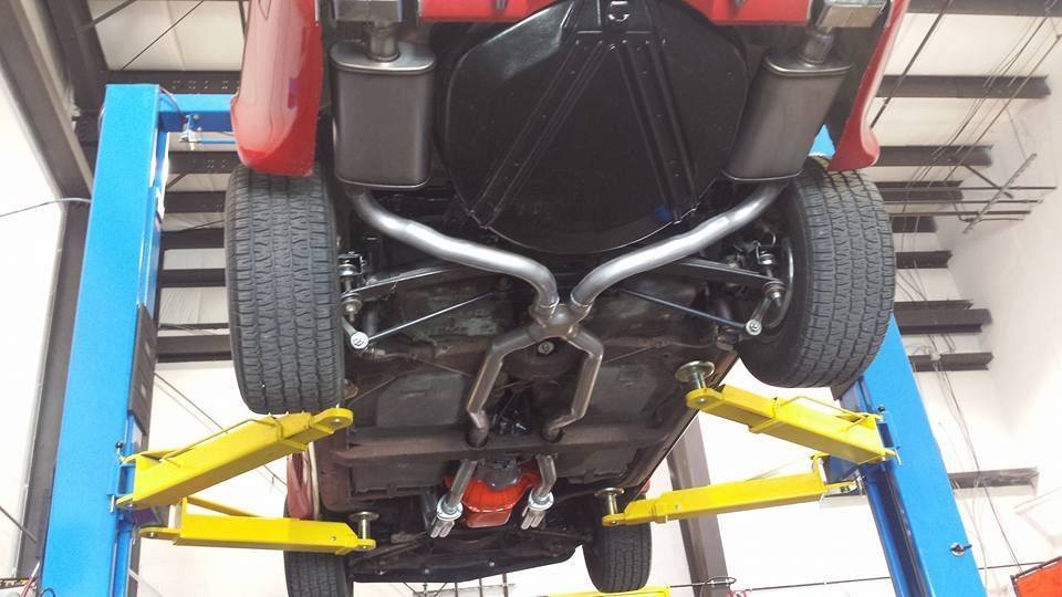

I just had a custom hand made system put on my car with Headman headers. Its not super loud at all. Sounds just right.
The new exhaust sure came out nice though huh?

Just copy L Holmes picture and tell the shop, this is what you want.
