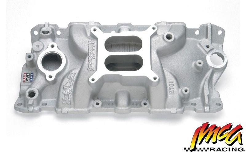

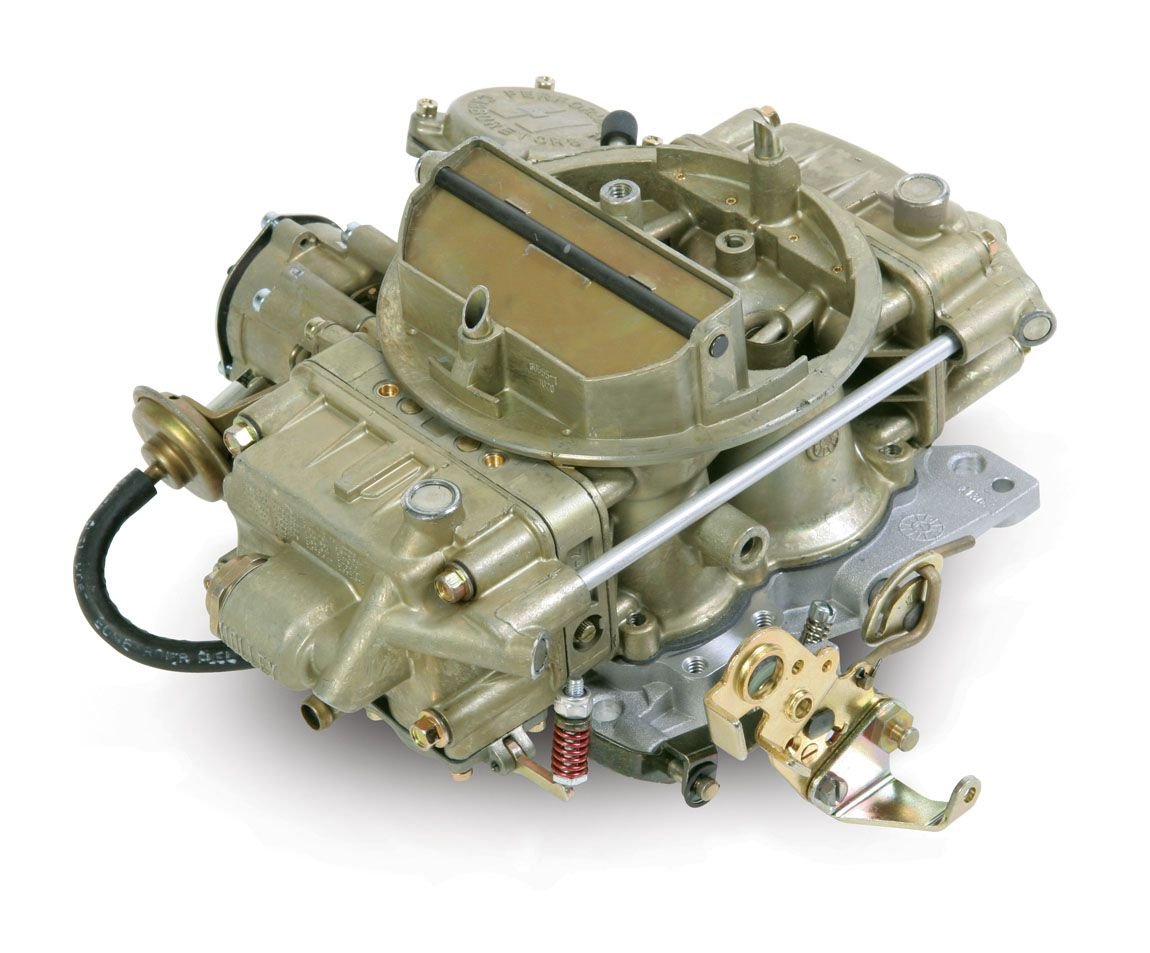

the standard Performer eps (non rpm or air gap...) dont see many people going smaller on carbs... 650 is plenty for that engine though I would stay with the quadrajet If the one I had worked... (mine came in a box with the car but had been dropped and looked rough.) have the holley 670 avenger now works well but needed to be rejetted to do so. I sold the new performer intake and chinese cast carter/edelbrock carb that was on it when I bought it... aluminum carbs dont respond well the ethonal.

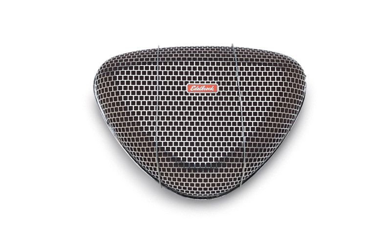

Air cleaner: 1002
Carb 1411 (750 Cfm Square bore)
Intake manifold: 2701 (square bore Performer EPS)

Carb: Holley 80555C (Spread bore)

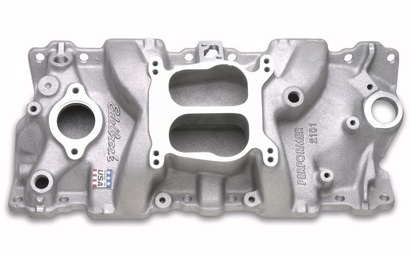

Intake: Edelbrock 2101 (standard Performer spread bore)

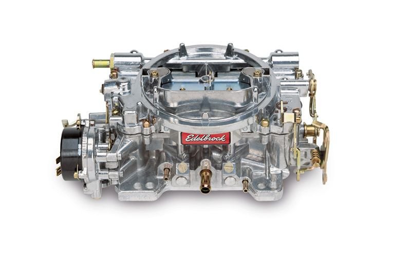

I'm using a standard square bore Edelbrock Performer with an Edelbrock 1406 carburetor.
Additionally, I have a 1/2" thick phenolic spacer between the carb and intake.
With a drop base air cleaner, I still have clearance under my 1977 stock hood liner.

Yes, I have an air gap and a Holley double pumper in my 66 427. You need a drop base air cleaner.

I am using a standard Edelbrock square bore Performer manifold with an Edelbrock 1407 carb with a drop base air cleaner under my 78 Pace Car hood with no issues.
