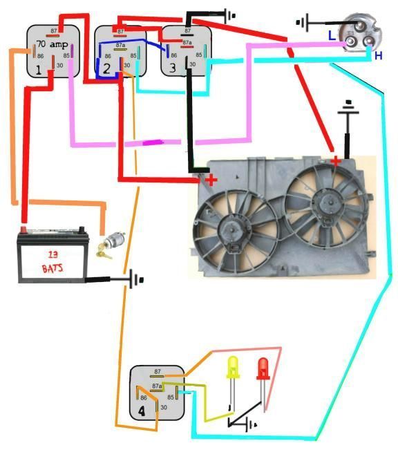

A neat trick with dual fans is to use 3 relays and 2 temperature switches to get a low and high fan speeds. The fans will run slower and quieter unless full speed is needed.
I do love the "something fails and you're stranded" comments related to electric fans. I'm sure I could find roads open enough to keep the speed up until I got home. But then most cars on the road today use electric fans and you don't see many of them stranded on the side of the road.
That is what I came up with does the same as the expensive comp ones and for me almost free to make,
My switch is that bmw one but that could change during testing.
My 383 would creep up with the Taurus fan but the 454 was okay with it, my 66 ran cool with a 327 300-350 hp and fiero fan.
I almost got stranded years ago in then 86, I had been playing with an adjustable temp switch to kick the fan on sooner and the switch burnt up, I just hot wired the fan to get home...but yeah, most all new cars have electric fans and when these cars leave people stranded it's seldom a fan issue.

I was going to run series/parallel for my high low operation on my fans. I decided to just run one/two fans instead. I liked that idea because it only took a total of two relays to run the fans and the LED indicators. The full load of two fans kicking in never passes through the relays. Most of all, if one relay does fail, the other will still get me home.
So far I have been very happy with the setup. The second fan has only had to kick in a couple of times, but it is there if I need it. I ran a ground wire back under the dash in case I want to add a switch to manually kick in the first fan, but have never wired that yet.
I'm not a big fan of that wiring because it leaves the left relay as a single point of failure. The more common way, which is the stock way GM it, will leave a single fan running when any one relay fails, or wiring for one relay or even one of the temperature switches.
An example is in the first post in this thread.
http://944hybrids.forumotion.com/t12...iring-question
To make it even more unlikely to have complete failure, AND to further copy how GM does it, you run a separate fused power wire from the battery to relay #1 and #2 and different fused ignition power to relay #1 and relays #2/#3. That way, a single fuse failure doesn't kill both fans.
Keeping both fans on all the time have cooling advantages and the two speed wiring soft-starts the fans which presents less electrical draw when they first kick on which is easier on everything in the system.
Ya, if you make sure the wiring and relays are suitable for their use then you won't have any issues. The one place I have seen relay issues is with the cheap pre-made relay plugs. The connectors are such crap they can't handle the current. Socketing your own with good Packard 56 connectors works MUCH better. Or grab some high power relays and harnesses off junk cars. You can find a matched sealed relays and pigtail harness on different models.
Old Jun 8, 2016 | 05:40 PM
The13Bats's Avatar
The13Bats
Joined: Mar 2003
Posts: 11,608
Likes: 780
I am betting since you do not like my way you do not run it...that's wise
in that wiring on low the path runs both fans through two relays, interesting.
please post some pictures of the set up on your car....
