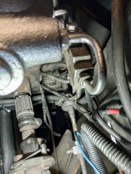

fwillison
I'll go look at my April 1968 just for ***** & grins for comparison purposes but I have a question:
DId you ever put the original good master cylinder back in to test it? Meanwhile I'll go get a picture of my 68 brake lines.
Pressure bleeding has always worked fantastically for me. I even do my other cars with it and it's great for system flushing.
I'll be back....

Thanks for the pic. That comports with the AIM diagram as well. I guess a previous owner switched the lines. I have them corrected now, though, so front goes to front and rear goes to rear. As far as the original master cylinder, when I went to bench bleed it prior to putting it back on the car it fell out of the vice and broke the mounting flange. My luck. I was pretty frustrated and got sloppy, which is never a good thing when working. It's probably just as well though, since when I removed the dust boot to bench bleed it, there was some seepage noted so it probably had a slow seep from the seals and was getting ready to give up the ghost anyway.

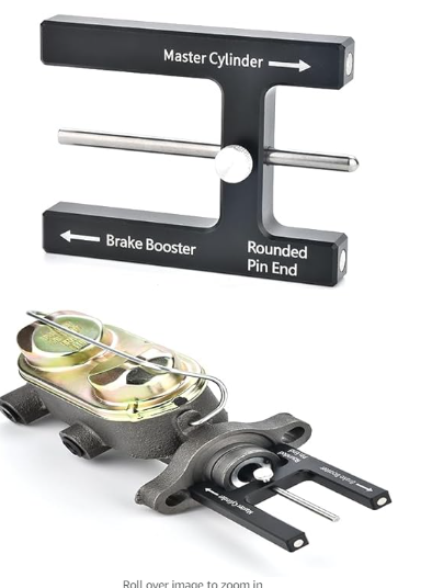

First-There are two master cylinders with two depth of pushrod cups. The pushrod should fit with almost no slack. You need to check this with any new corvette master. You need this gauge or a digital caliper to check the pushrod depth.
Second - did you bleed the MC on the bench and tilt it both fr/bk while doing so? That ensures all the bubbles get out.

Great post, I've not heard this anywhere before. I was just thinking about the pushrod to MC specs last night while ruminating about my issue. I noticed when installing both master cylinders (which were identical Dorman units) that the MC was held off the firewall a quarter inch or so and it drew up tight to the firewall as I tightened the nuts. I didn't think too much of it at the time, but lately beginning to wonder if this indicates a problem with pushrod adjustment (or now as you point out - master cylinder cup depth).
Is it possible that the pushrod or MC cup is being inordinately "preloaded" preventing the cup from fully backing out on release of the brake pedal? If so what would this do? Maybe reduce the "stroke volume" of the master cylinder? One point on that issue is the fact that reversing the reservoirs to properly route the front to the front and rear to the rear did not change the location of my issue (reflected by the hose clamping results given previously).
Where do I get that special tool? What are the specs I'm measuring for?

  #58
leigh1322's Avatar
leigh1322
Old Pro Solo Guy
Posts: 8,124
Likes: 4,484
From: Marlton NJ
Here is a
link link
to the tool on Amazon.
Here is a link to a previous discussion with a pic showing the two different "cup" depths.

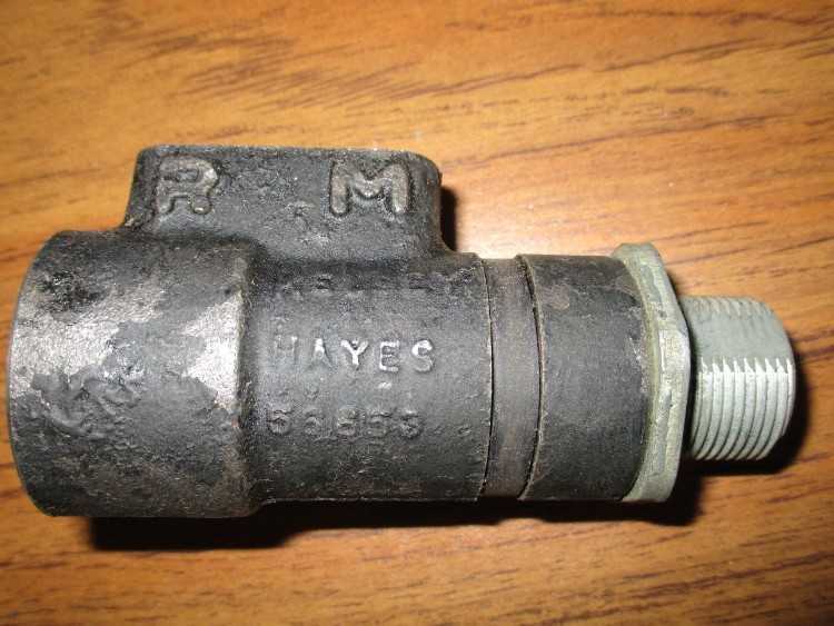

Well 68 did have a lot of one-year parts!
Hopefully it still has the pressure switch inside.
And for your viewing pleasure here is a NOS GM Adjustable Proportioning Valve # 3878944
Only known factory installation was on L88s, and 4-wheel J56 disc brake Z28s.
Possibly ZR-1s or ZR-2s with J56 HD brakes.
It can be yours for only $2500! LOL On NCRS.com.
And to think I ran one on my 70 Z28 pro-solo car, because it was "cheap" (almost free)!
Who knew?
It is the one mentioned in the Chevy Power Book, which even gave a chart of the pressures at different adjustments. Just turn the ****. It did make a huge difference in how much rear braking power I got. I could finally lock the rears before the front LOL. And when I got it tuned just right, I got up to 1.27G braking. In the 80s.
That is a very rare part. I sold one of these that was NOS along with the caliper brackets to a restorer about 20 years ago.
