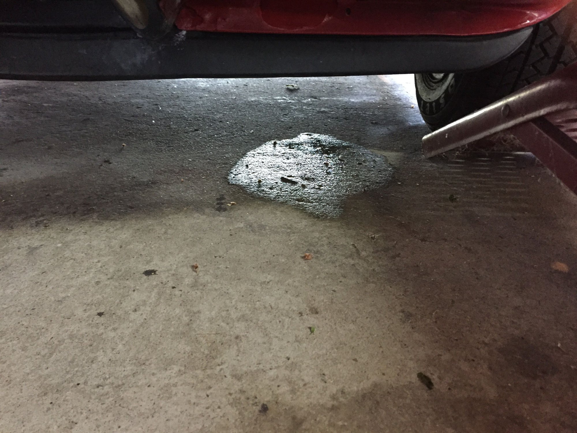

Same reasons here. Glad to hear it's working out so far. Glad I ordered it. The leak didn't stop like it had previously after the radiator wasn't under pressure. Woke up to this:
After it was sitting for a day. Either way I think this will be a good replacement and cost effective.
