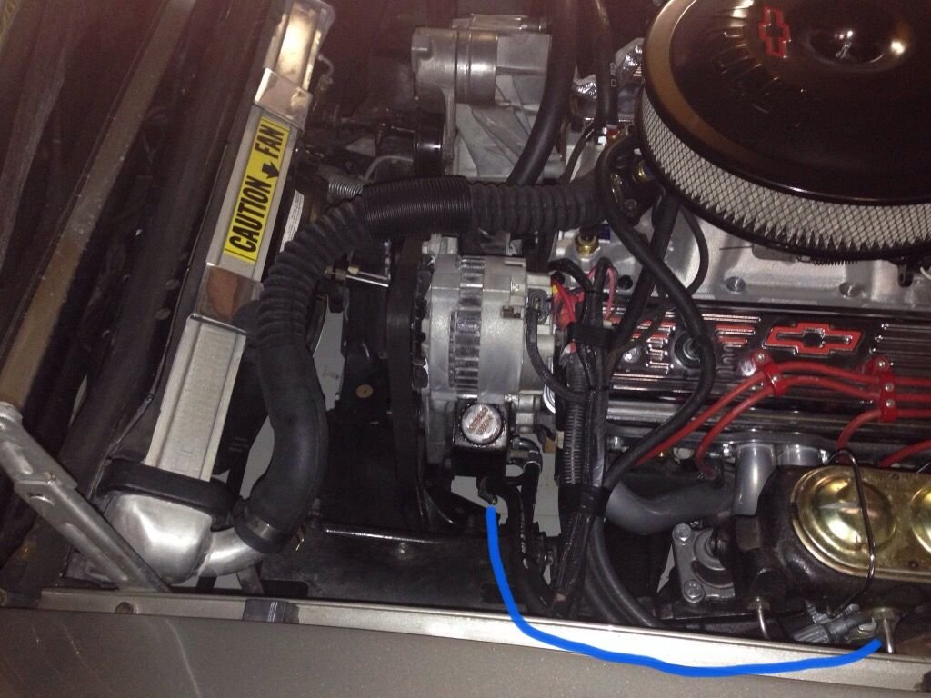

Mine comes up towards the fender and under the edge of fender and back down to the steering gear. Mine is a big block so their was no other alternative.

Im actually runnin a 90's smallblock GM serpentine set up on my big block. I do remember the SB bracketry though.

Might not help you as it's a serpentine setup
Nick

Samen as Dembo but big block
