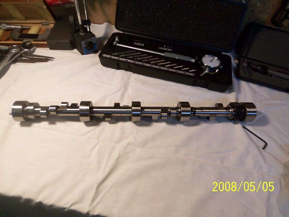

When you buy any roller cam it is worth spending a few extra buck and getting the billet steel with a sleeved on distributor gear.

This is one thing everyone should do. A few years back when I was spec'ing in a cam for my 427ci I called Comp Cams and gave them all the numbers ( you see at the end of cam ).
It was basically an Xr286R solid roller with a few duration and lift changes and I ordered a billet cam with pressed on iron gear. I also ordered a small base circle. The cam I got was a work of art At the time all this cost me only $40 extra, not sure how much it costs now but it is still worth the money
