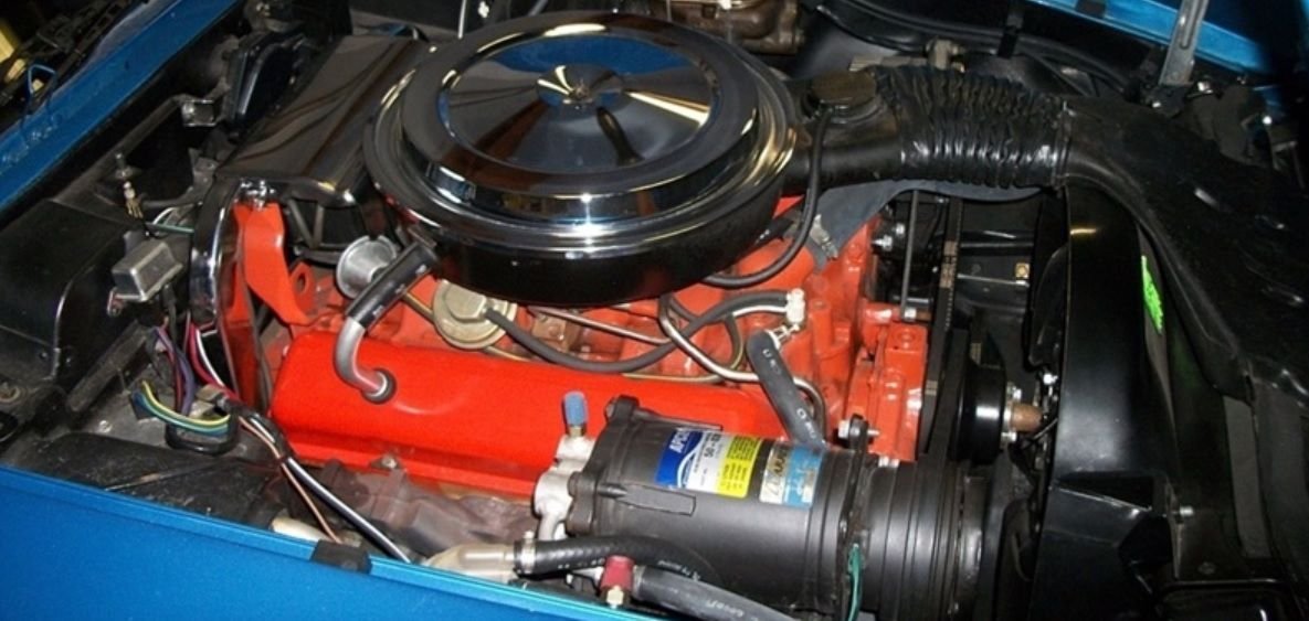

As I mentioned earlier will be in the shop Monday with the car however, curious, can anyone show me where the low side A/C port is located on my 76?
Thank You
Thank You
If yours looks like this one, the blue cap is the low side and the red cap is the high side.

Bond007's Avatar
Bond007
Joined: Jul 2000
Posts: 418
From: Iron Mountain,Michigan
Thank you very much 71 green 454 that is exactly what I am looking for. Yipee Beautiful engine detail I'm jealous.
Glad it helped....that engine is not mine, I just found it for reference.
My '71 is a BB.
