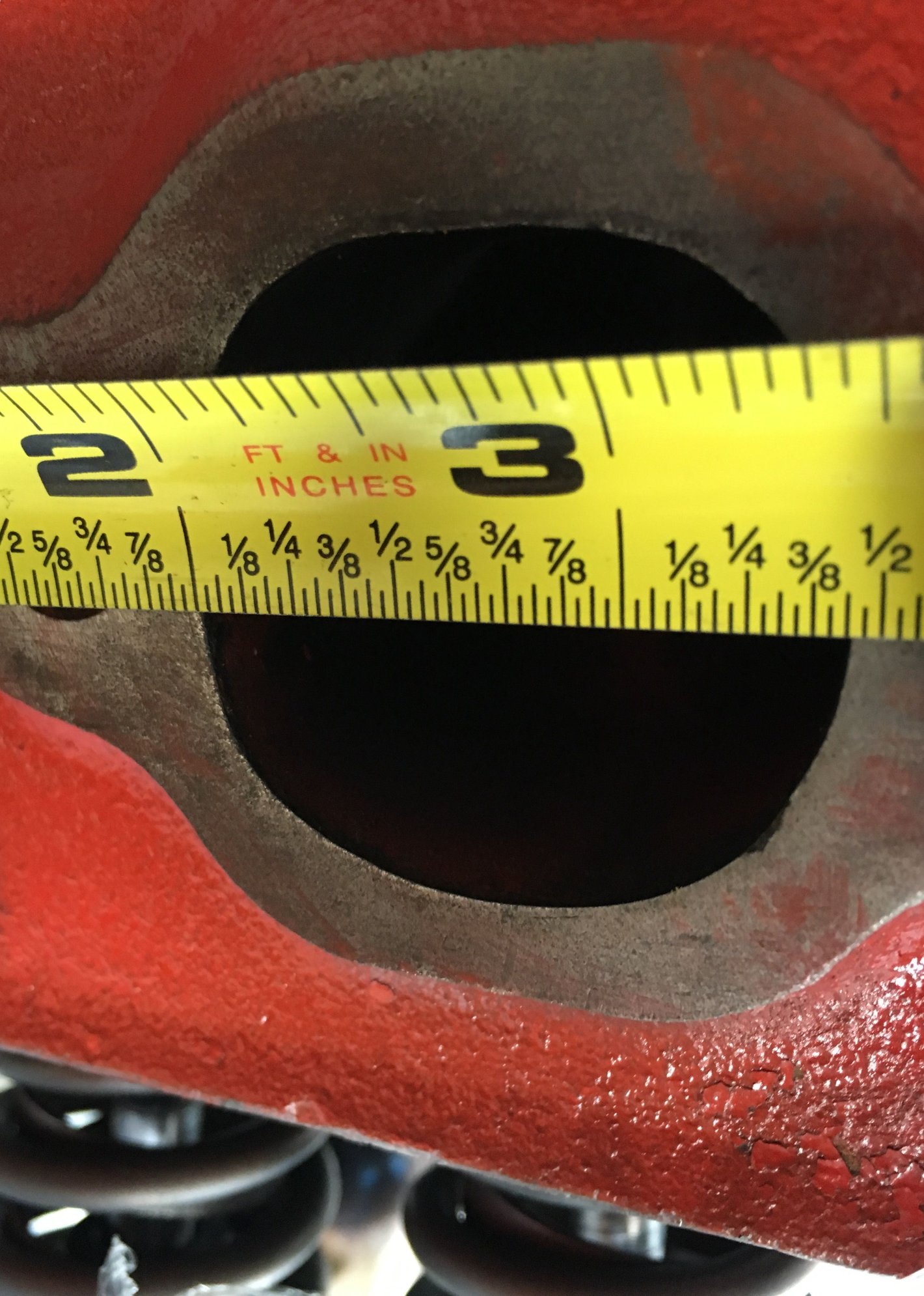

Hi ....
I have a chevy small block i just had it rebuilt & bored out from 0.30 to 0.40
I want to buy new headers being the old ones are rusted & pitted (no holes). I measured the exhaust holes (oval shaped) on the block i belive they are 1 7/16" or 1 3/8". Im havin trouble finding that size. Is it possible to put on a different size ? Or do i have to find that specific size? I have tryed ebay, summit, ect..... I cant find them please help tanxxx guys ✌🏼️

Old Jul 28, 2016 | 11:52 AM
gerry72's Avatar
gerry72
Joined: Aug 2000
Posts: 3,711
Likes: 43
From: San Antonio TX
The header flange and pipe diameter will almost never be a precise fit to the head's exhaust port dimensions. Unless anyone is referring to a race head, the pipe will be larger and overhang the port. This is just fine. The one thing you don't want to happen is where the header flange/pipe are smaller or out of position and the port overhangs the flange/pipe, meaning the exhaust gasses hit the flange. You are not going to have this problem. The smallest primary tube you will find is 1.5" and those are not all that common. The most common size is 1 5/8 for cheaper headers and these will be a good fit for your port and usually offer fewer fitment problems. More expensive headers, like Hooker Super Competition, will use a 1 3/4" pipe. Some headers use a 1 7/8 pipe. Larger than that and you have to get port plate adapters.
So, in summary, you are just fine with any header you choose.

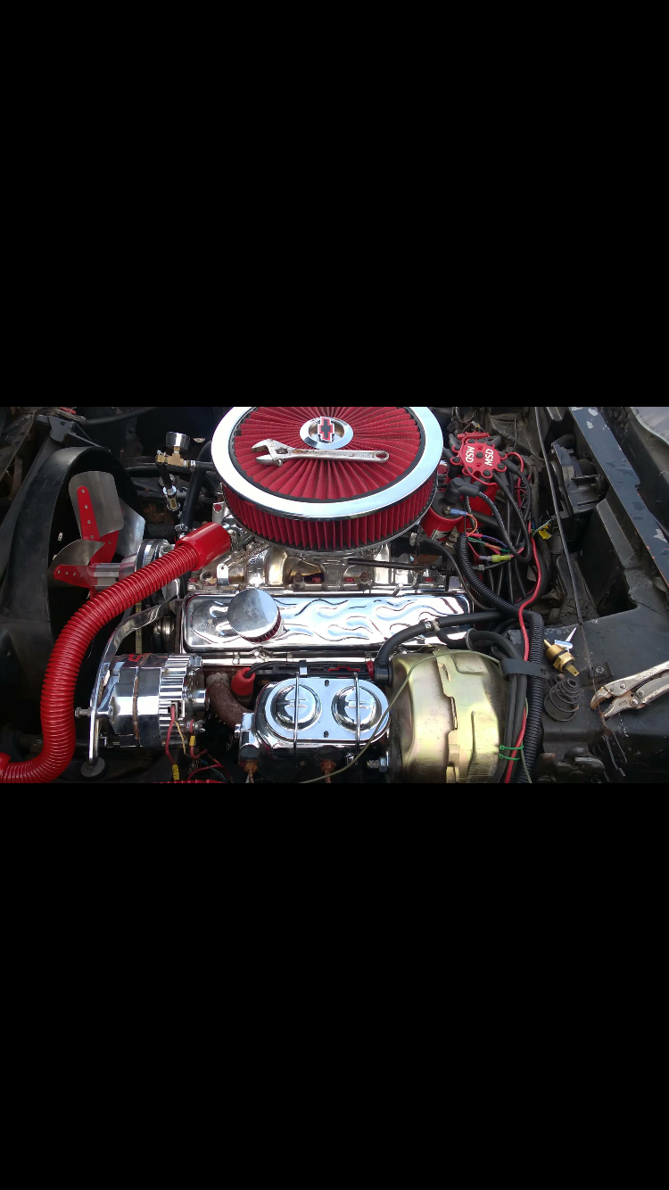

This is Just to have a idea what i have running
Before
Old Jul 28, 2016 | 07:40 PM
hardmansonfan's Avatar
hardmansonfan
Joined: Jun 2014
Posts: 126
"After"
But before last weeks engine rebuild. It also has a holly 4 Barrel Aluminum Street avenger carb "650" & msd 6al-2 ignition box
