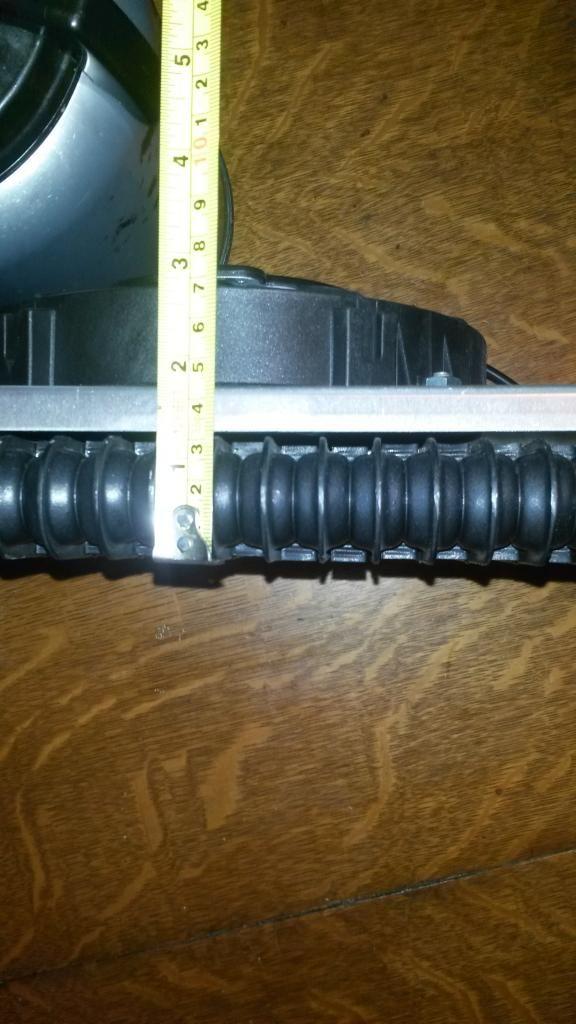

Here's my solution.
I needed a cooler that would fit in that area below my center grill on my 74. This will fit
The stacked plate design was a no-brainer for me.
Here's the thickness of the cooler as well as the shroud and Spal fan. Yes Spal and never look back.

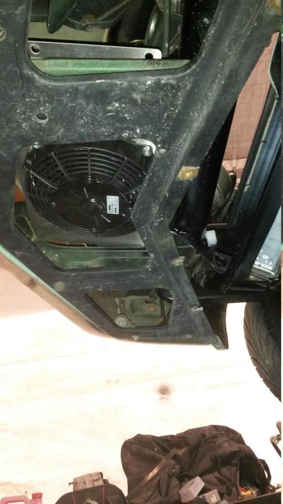

A simple aluminum shroud. Can't stress the shroud part enough
Here's the spot I've picked out. I had to remove the spoiler and air dam to access the area
This gives you an idea of fitment
Here she is with everything back in place
For fan control. I have an inline n/o temp switch. Most evening and on cool days the fan won't even come on. When the temp here in Oklahoma approach 95 deg plus, the Spal fan gets to chime in on duties.
