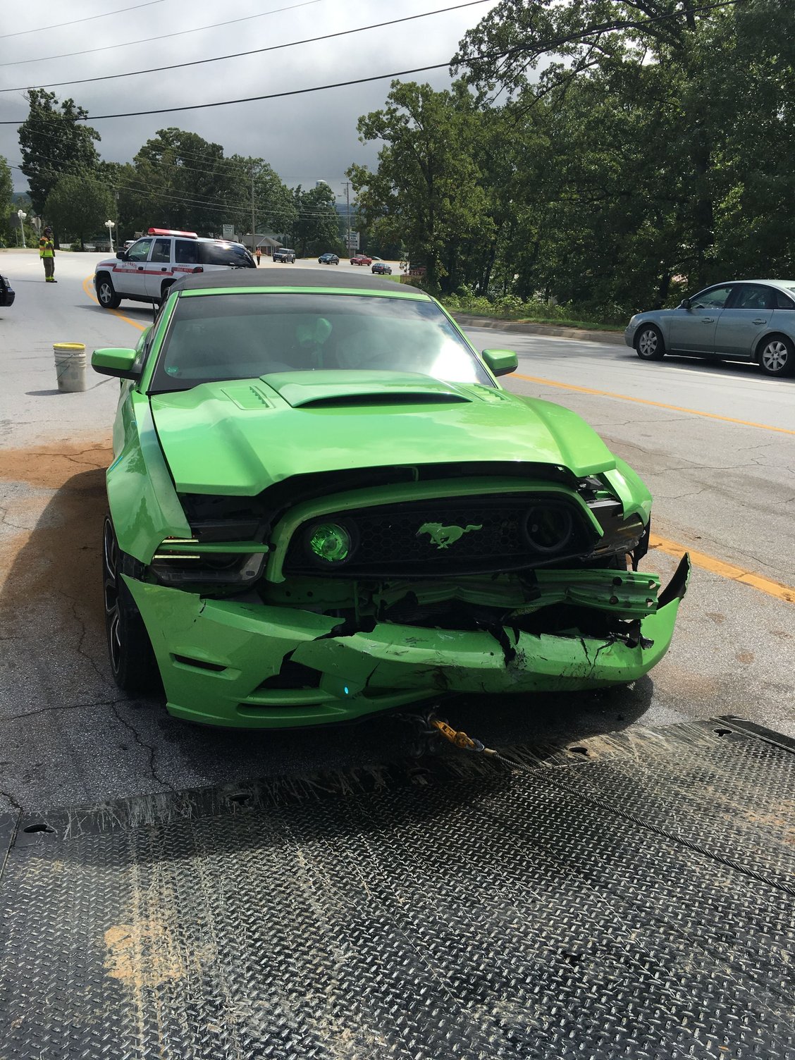

Read an article about the swap, having trouble finding more information.
Buying a wrecked mustang.
It's all there 6 speed manual/ 5.0 coyote. My corvette now is a 4 speed Muncie, Any info swapping modular fords into the C3 would be appreciated.

Originally Posted by Vaipulu
Donor car, if it's worth it, I want to buy it back. I really enjoyed the 5.0 coyote and its 6 speed trans over its LS powered camaro rival.
Bummer on the wreck.
