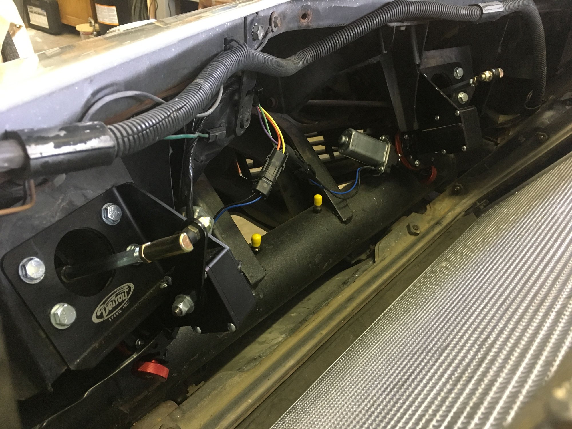

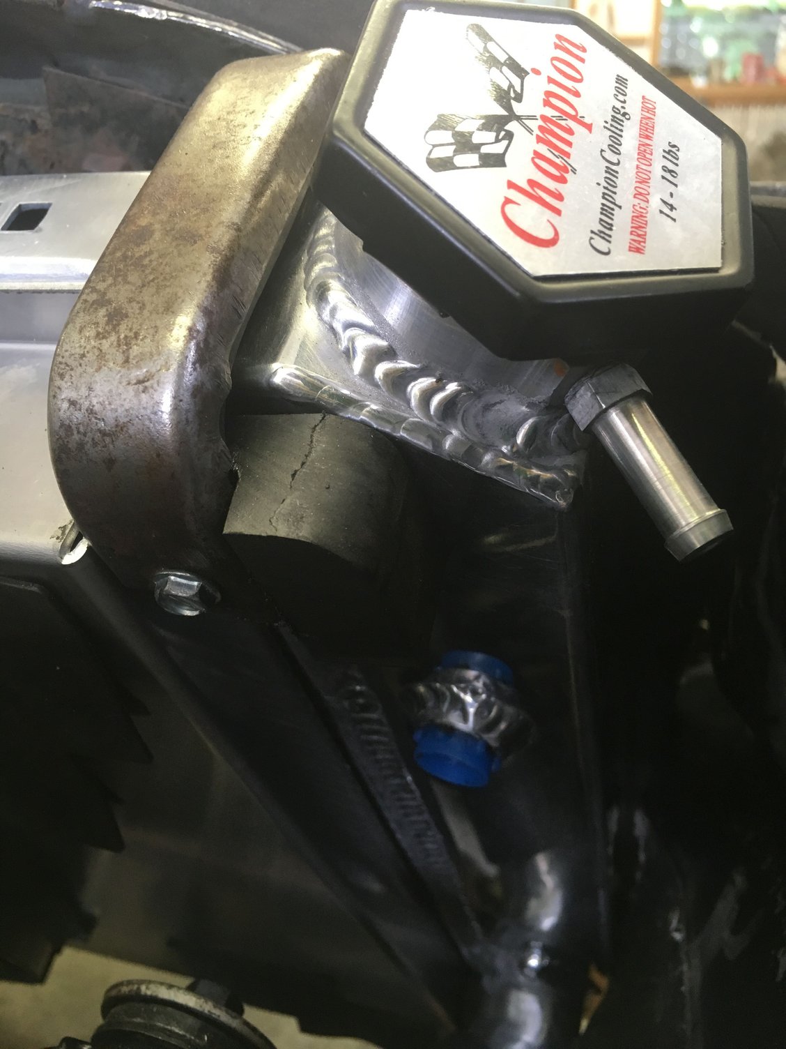

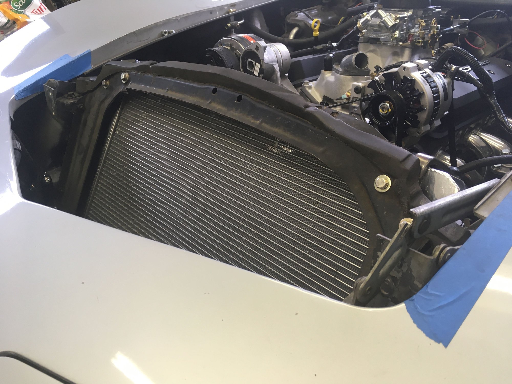

I got the Champion 2-row for my car. 75 ac coupe with a ZZ6 crate. I ordered it with their shroud and 16” SPAL hi perf fan which they offer as an upgrade. After some fiddling around with the brackets I ended up making custom phenolic block spacers for all 4 corners. It is solid as granite.
Also I tricked the relay controlling the fan into thinking the key is “on” all the time. If you shut the engine off when it’s toasty the fan will run until it’s cool.
Everything seems very well made and a fair deal. George at Ledfoot Racing has been very helpful with after sales support.
