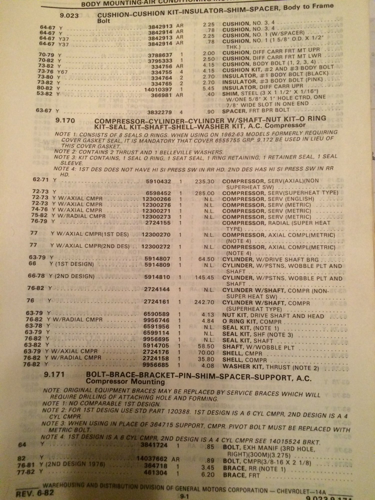

The Corvette Parts and Illustration Catalog, Effective June, 1982 lists two compressors for the 1977;
77 Y W/AXIAL CMPR (1ST DES) - 12300270
77 Y W/AXIAL CMPR (2ND DES) - 12300272
1st Design does not have HI SI PRESS SW IN RR HD. 2nd Design has HI SI PRESS SW IN RR HD.
Good luck... GUSTO
