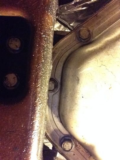

Hi Dirk,
My car was original with a TH400. I kept the factory cross member with the 2004r.
If you go that route, know that the rear pan bolt is hard to get to. The transmission needs to be lifted up an inch or so to get to it if you need to pull the pan in car. (not a big deal)
There are cross members that allow you to straighten out your exhaust. And, the factory routing for a TH400 was possible but too close on the 2004r. I had new pipes run to allow the pan to be removed easily and V-band clamps installed at the header and just after the cross member.
