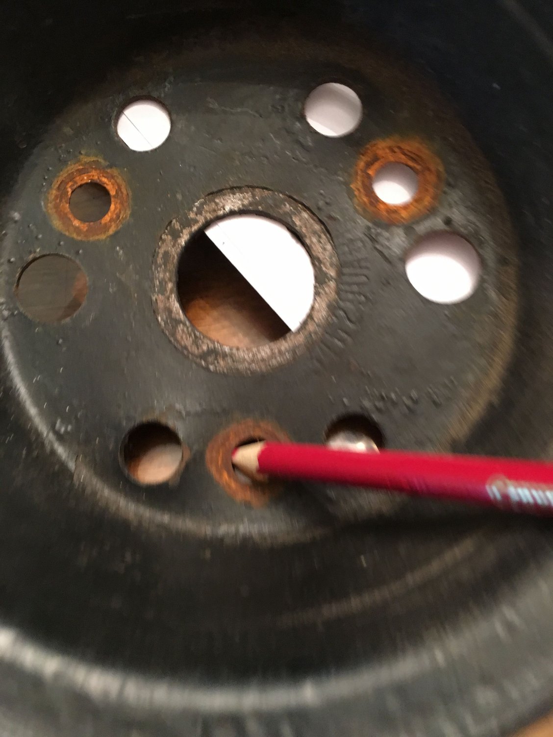

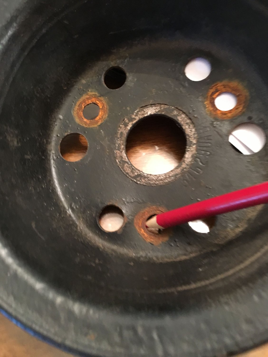

In the process of chasing down a metallic "clinking" noise in the front
of the motor in my '75, I found that both pulleys on the damper were
cracked thru the holes in the hubs. They were totally ready to
shatter, probably with very expensive results. I have new pulleys coming
but am nervous about just putting them on with no idea why the others
failed. All bolts were torqued correctly and alignment looked good.
Anybody have any ideas or seen this before ?
TIA
Larry

Originally Posted by leskinner
In the process of chasing down a metallic "clinking" noise in the front of the motor in my '75, I found that both pulleys on the damper were cracked thru the holes in the hubs. They were totally ready to shatter, probably with very expensive results. I have new pulleys coming but am nervous about just putting them on with no idea why the others failed. All bolts were torqued correctly and alignment looked good.
TIA Larry
This is not an uncommon problem (or symptom - good catch!) for the crank and water pump pulleys. I believe that GM even included a reinforcement plate that could be added to help distribute the load more equally with some pulleys. The secret is to thoroughly examine the hubs of the pulleys any time your remove them and replace any that are suspect.
Pontiac Lower pulley reinforcement ring
As far as causes go, I would guess the primary factor leading to early fatigue is running belts too tight, followed by pulley misalignment, the material the pulley is made of and finally the distance between the pulley groove and the point on the pulley that bolts to the balancer/water pump. Sheet metal pulleys are more prone to cracking than cast pulleys, but cast pulleys do crack as well.
AMC water pump pulley...
SB Chevy water pump pulley...
Sorry, I just couldn't find a good picture of cracked-crank pulley! As you probably well know, the cracks in the crank pulley are exactly the same... results may be different, but the cracks are the same.
Good luck... GUSTO

I found the pulleys on E-bay (used) and rec'd them yesterday. Bead blasted them and both are cracked, Not as bad as my original.
I have been thinking about welding the cracks and making the reinforcement as you suggest. Your opinion on welding ??
Larry

Honestly, without actually seeing the pulleys and the cracks, I think it's a conversation I would have with a qualified machinist in your area. At the very least he (or she) may have a suggestion that provides a better solution. The metal is pretty thin, so at the least I think I'd be looking at TIG welding it.
You may also find that new pulleys are available. Do you have the part numbers of the correct pulleys? Can you tell us what pulleys you have on your engine? Power steering, AC, alternator, air pump? I.E., Harmonic balancer pulley - 2 groove, 6 1/2" outside diameter...
