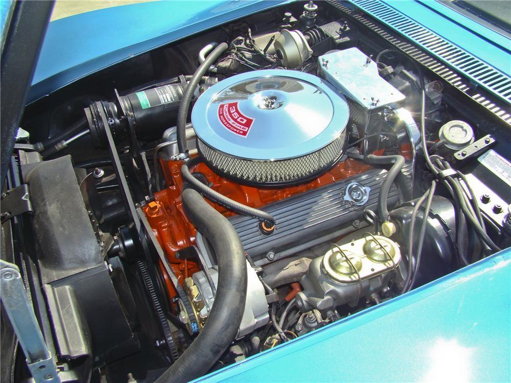

I have the OEM L-82 valve covers on my rebuilt L-82 355 with AFR heads:

I'm able to use my oem finned covers also without any modifications on my AFR 195's. The AFR heads have a raised rail for the valve cover thereby permitting the use of oem cover. Not sure about other head designs. You could also double gasket or add a spacer.
