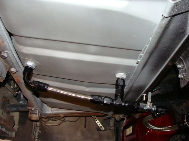

I installed a sump that the diesel guys are using, bolts to the tank without welding. I also purchased a couple fuel tank fittings that secure with Teflon washers and a nut. The fittings have rounded inlets for better fuel flow. I ended up installing the sump and didn't use the fuel tank fittings so I don't have first hand knowledge on the install.

The fuel bungs simply screw together with a nut and teflon washers.
I sealed mine in with an aircraft fuel tank sealant that I found on the internet.

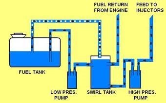

Also if you did feed the sump by the mechanical pump would you use two(or even 3)returns to the main tank (one from mech pump, one from sump and possibly another yet from the electric pump?)

You use the return line from the mechanical pump. I believe you could just T into it or you could plug the outlet at the pump and re-route the line to the to of the surge tank. The return from the EFI system goes to the surge tank otherwise the electric pump would empty the surge tank.
Yes, if you kill power to the pump the engine won't run.
Like this (where fuel return from engine is from the electric pump?

Yes, basically like that.
