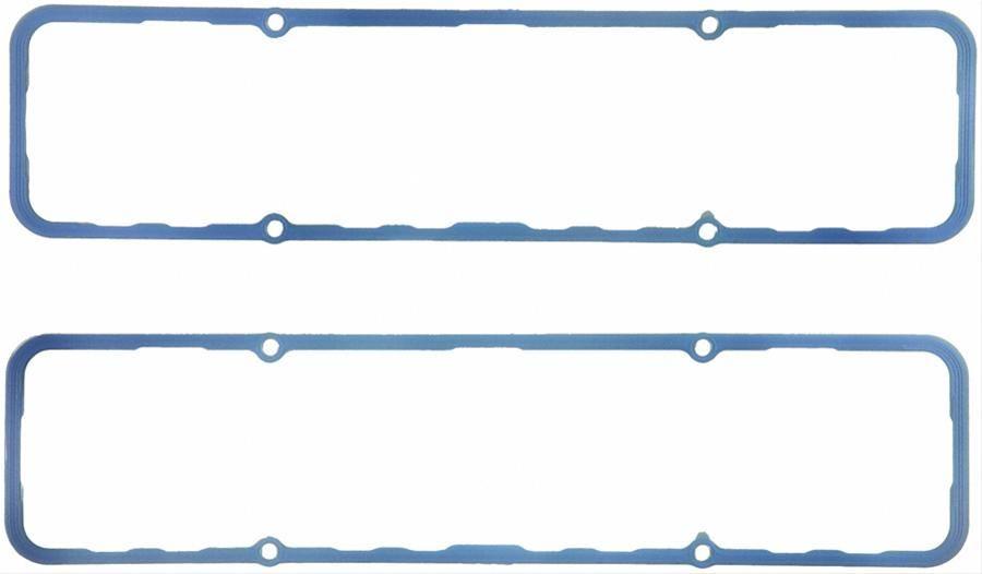

I believe this is them:

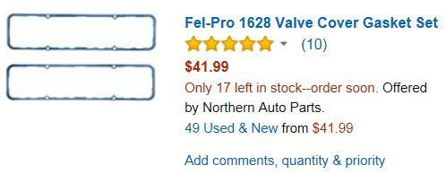

Looks like Fel Pro 1628's for the win! thanks everyone.
