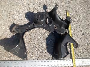

I wanted to use my remaining cash for my new paint so I did the salvage yard thing. First I measured the diameter of each pulley that I needed and found salvage yards that stocked older vehicles.
I didn't want to go the route that included the forward mounting accessory bracket.......
I found the correct pulleys on late 1980s and early 1990s trucks....haven't installed them yet....I'll probably use the alternator adjustment to tension the serp belt as you said.
I made sure the crank pulley was similar in diameter to the original pulley/the I.D. (hole size) for the fit on the crankshaft was identical....and the backspacing was the same/or slightly less so the rear shoulder of the pulley could be shimmed if it rubbed against the engine block.
On the waterpump pulley......same procedure....being a machinist I can drill new bolt holes if the serp pulley bolt holes don't have the same pattern....I can also add backspacing shims so it will align in the same plane with the crank pulley.
The alternator can be shimmed forward or rearward as needed.
P/S is N/A.....but I would use the same procedure.
If necessary later on I will adapt a belt tensioner to the engine.
Hope that helps.......total cost about $40 and a can of black spray paint.
