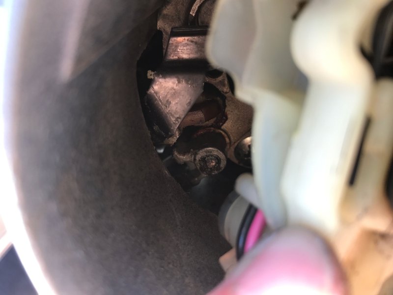

My dimmer pivot broke, and I know they don't make that part anymore for the '77s, and it looks like the ones for the later cars have also been discontinued. Not sure what to do now. Has anybody had any luck repairing these things?

Is that a broken pivot or a broken rod? Looks to me as if the rod sheared off at the socket. If so I'd suggest drilling into the rod stub and using a broken bolt extractor. The dimmer stalk is--I believe--available.

It's definitely the pivot. I had the stalk out yesterday and it was fine. At the lower left of the photo in my previous post you can see the broken casting. It broke in the same spot as this '78 pivot:

J. B. Weld is some pretty amazing stuff Be sure to use it around the break anyplace that clearance won't be a problem.

I was hoping to just replace that part but it looks like I don't have much of a choice. I guess I'll have to try to fix it. I'm just concerned that the JB weld won't hold up very long.

Clean well and again put as much as possible around the repair.
My experience with J.B. Weld is that if it works through the first stress test you can consider it a permanent repair.
I've used it on a number of cast iron radiators (used in hot water home heating systems) with general success. I test the repair under hose pressure (say 60 psi) when system pressure should never exceed 12 psi. Those passing that test have been in service for decades.
In that vein I'm quite confident in saying that if the repair lasts (after a few days curing!) through the first firm pull it will last indefinitely.
