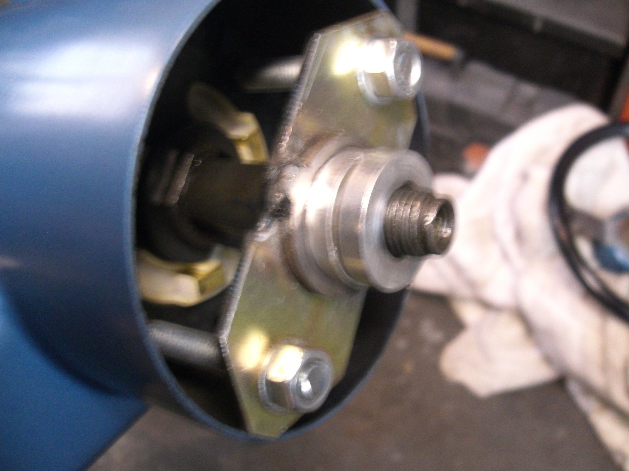

Lock plate compressor tool
I cobbled this tool up yesterday to do the very job you are doing. It uses the steering wheel nut to compress the plate.
