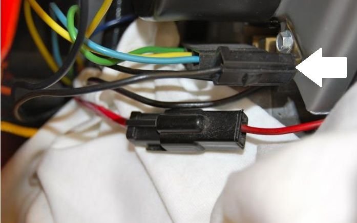

Can't tell from your avatar-
But looks to be 68or 69-
The wire also grounds your blower motor and connects down at starter/bellhousing bolt
This pic is from fellow forum member "Alan 71" - my pics look no where as nice!!!
