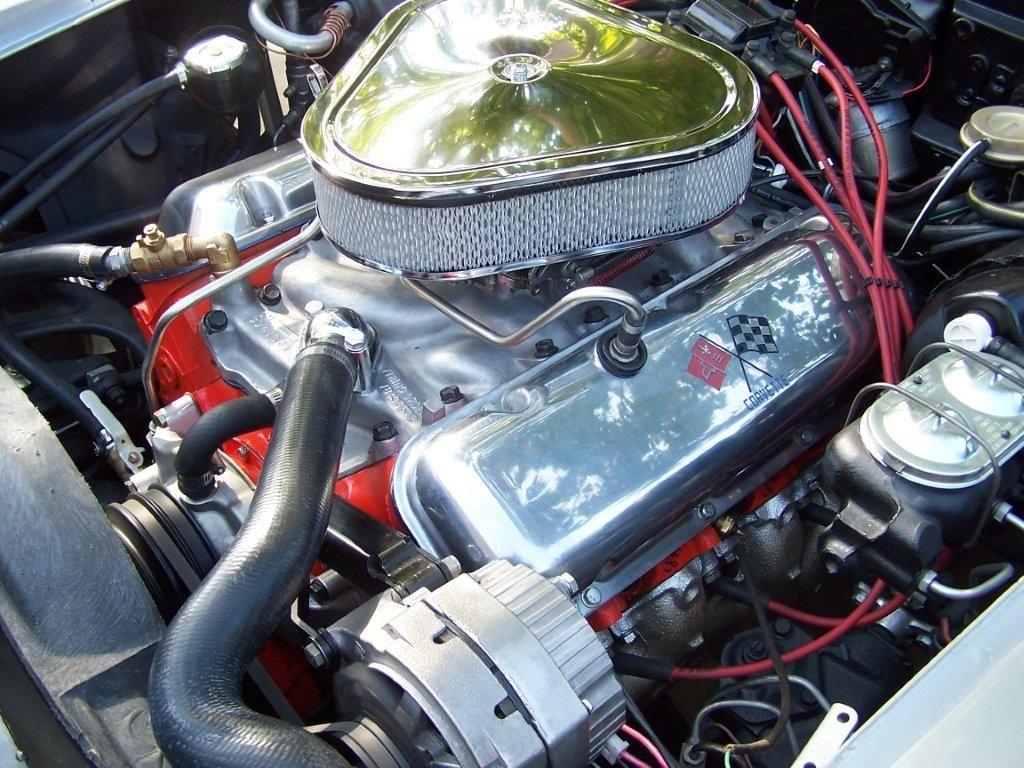

Old Feb 2, 2017 | 05:22 PM
69Vett's Avatar
69Vett
Joined: Oct 2007
Posts: 3,729
Likes: 267
From: Austin Texas
Corvette of the Year Winner 2017
2016 C3 of Year Finalist
another with BB original Aluminum intake.
made my own custom drop breather.
To Intake 72 BB.
