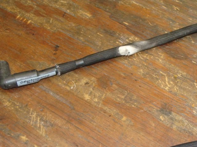

I've been having some problems with a very slight miss in my engine. I figured I would look at the spark plugs and see what's going on. My number one plug was black. So I looked closely at the number one spark plug wire. Here are photos of what I found. The wire got up against one of the header tubes. I installed a spare wire and new spark plugs. She is running great now.

Glad you found it, shame it ruined the wire, that was a good set. Peculiar though, looks like a high temperature covering. Mark

Glad to read the good news! Yes you need an air gap between plug wires and header pipes/manifold - no contact no matter what material.

The wire set is from Davis Unified Ignition. Live wires have a protective loom over the length of the wire. They have held up well in close proximity to the headers.

Welcome to the club. I took my car in for an inspection a while back and the mechanic comes back to me saying I have a miss, from either a wiped cam or a blown cylinder. It wasnt very noticeable, just the slightest BUMBUMBUMBUMbumBUMBUM....
I got home and prepared to tear down my engine. (I was on the verge of tears. The engine was only 3K miles old) The first spark plug wire I pulled (sleeved in asbestos like pictured in this thread) was burned out and arcing on the head.
DO NOT trust those asbestos sleeves to provide the heat protection you need. I had to dent the hell out my headers to get enough clearance to stop melting wires, even with the sleeve. Do not let the sleeve touch the header. You NEED some air gap.

I ordered a new set of wires and wire sheathing yesterday. I have used the spark plug sheathing before. Yes it works great. The spot where this wire was burned was hidden behind the #5 header tube. I'm using the under the header wire sets. I didn't know that it was so close when it burned. I will definitely be covering the new wires with some heat proof covers on the next go round. Stay tuned.
